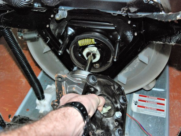

  • On the bottom of the machine, remove the 3 bolts that hold the transmission in place with the ratchet and a 3/8 inch socket.
  • Gently pull the transmission out of the washer.
