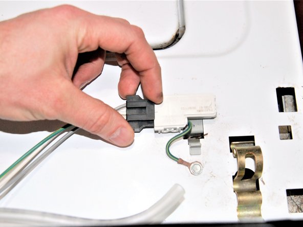

      • Pull the connector from the door safety switch located on the main body of the washing machine top.

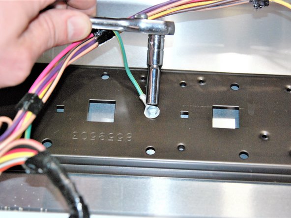

      • Disconnect the green wire ground point inside the control panel with the ratchet and a 1/4 inch socket.

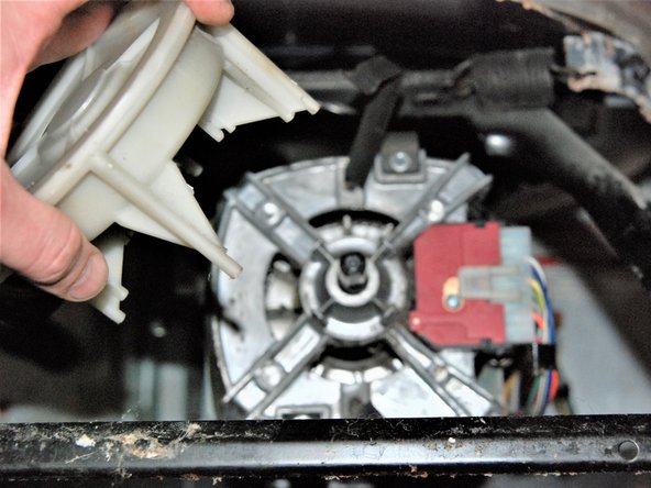

      • Lift the tab and remove the motor wiring harness connector.
      • Remove the plastic clip from the transmission housing.

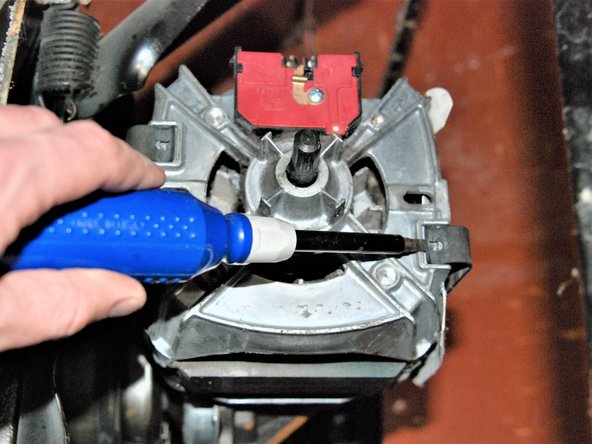

      • Remove the motor retaining clip screws with the ratchet and a 1/4 inch socket.
      • Use the flat head screw driver to pry retaining clips off of motor.

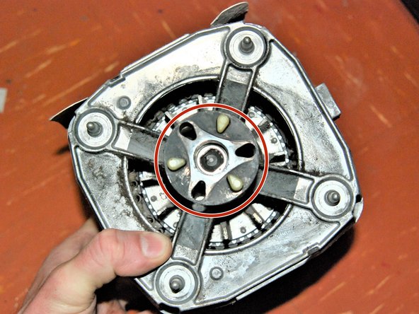

      • Separate the motor from the transmission.
      • Be sure to check the rubber motor coupling while it is apart. The motor and the transmission will have a plastic piece with three prongs that fit into the rubber coupling. Check to make sure plastic prongs have not broken and the rubber coupling is not cracked.
      • If the motor coupling is cracked or broken it will need to be replaced.
