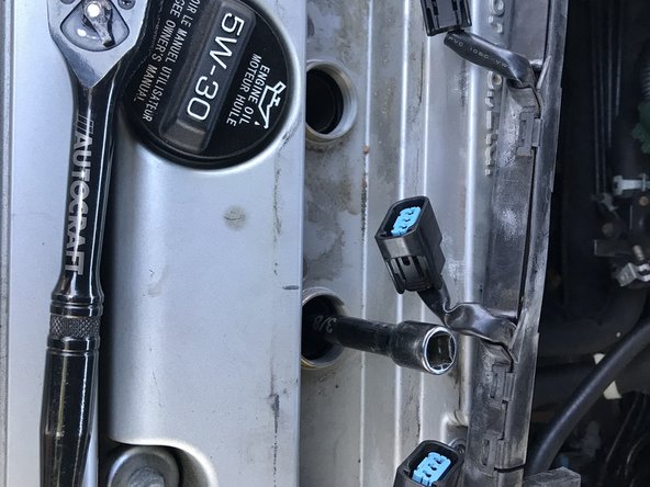

  • Pull the plug out of the bore.
  • Use a ratchet, extension, and 5/8 socket to remove the plug by turning counterclockwise until it's free.
