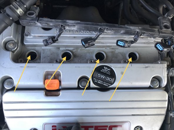

2004 - 2008 Acura TSX (CL9) Spark Plug Replacement, Remove Spark Plugs: crwdns2935265:00crwdnd2935265:01crwdnd2935265:03crwdne2935265:0 2004 - 2008 Acura TSX (CL9) Spark Plug Replacement, Remove Spark Plugs: crwdns2935265:00crwdnd2935265:02crwdnd2935265:03crwdne2935265:0 2004 - 2008 Acura TSX (CL9) Spark Plug Replacement, Remove Spark Plugs: crwdns2935265:00crwdnd2935265:03crwdnd2935265:03crwdne2935265:0
Remove Spark Plugs
  • Locate the spark plug at the bottom of the bore.
  • Use a ratchet, extension, and 5/8 socket to remove the plug by turning counterclockwise until it's free.
  • You can use a spark plug socket for an easier removal.
