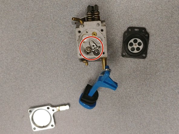

Diaphragm rebuild
  • Install a new float set and needle valve.
  • Install the float set and needle valve retaining screw.
  • Place a new diaphragm and seal in position.
  • Replace the diaphragm cover and the four retaining screws.
