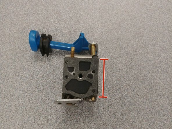

Rebuilding fuel pump
  • Align a new fuel pump valve and gasket with the carburetor.
  • Reattach the fuel pump top cover using the chainsaw T-wrench.
