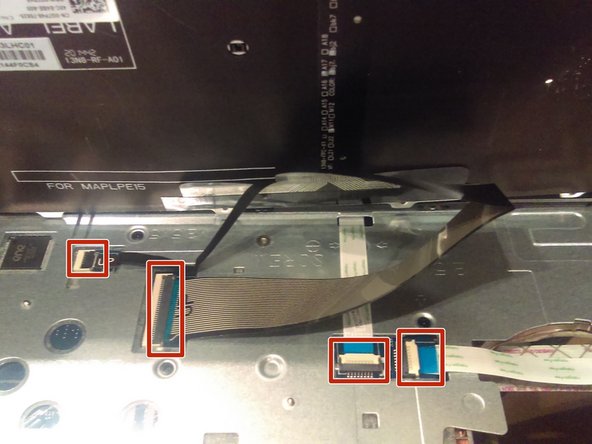

  • Disconnect all four cables shown, by lifting the clip and pulling the cables straight out. The keyboard can then be set aside.
  • When removing any cable, be sure to remove it from where it is attached, and try no to bend it too much.
