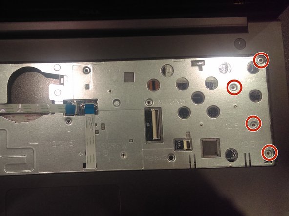

    • Using the Phillips J0 screwdriver, remove the ten screws shown.

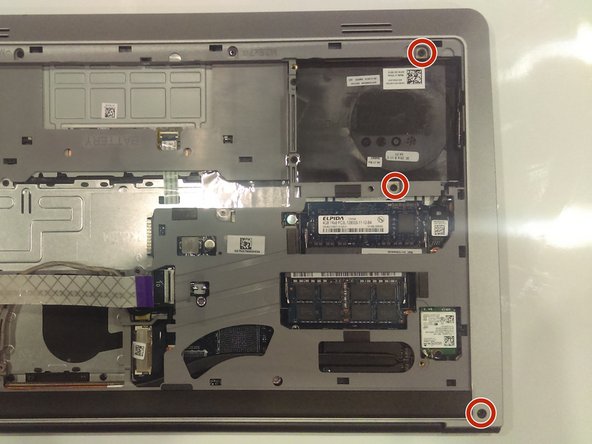

    • Flip the laptop to the back. Remove the wire indicated by puling directly to the left and pressing the cream colored bases, then use the metal spudger to pry off the case.
  13. Dell Inspiron 15-5547 Motherboard Replacement: crwdns2935265:013crwdnd2935265:01crwdnd2935265:01crwdne2935265:0
    • Using the Philips J0 screwdriver, removed the four marked screws, and disconnect the marked cable.
    • In the top left corner, the two screws to the left and right are removed first, then the metal hinge is lifted to access another screw underneath.

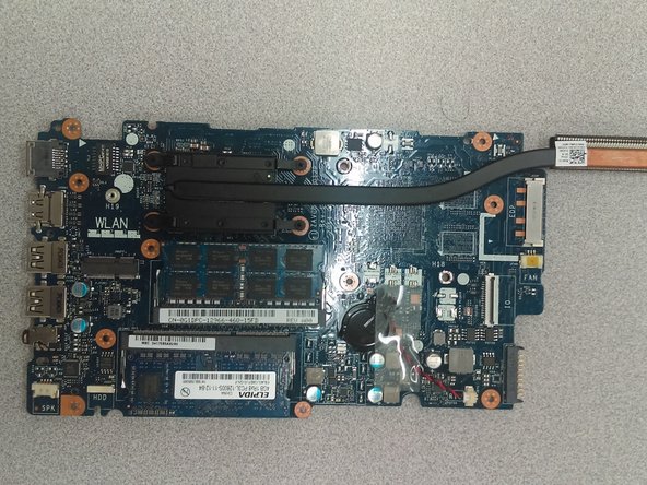

  15. Dell Inspiron 15-5547 Motherboard Replacement: crwdns2935265:015crwdnd2935265:01crwdnd2935265:02crwdne2935265:0 Dell Inspiron 15-5547 Motherboard Replacement: crwdns2935265:015crwdnd2935265:02crwdnd2935265:02crwdne2935265:0
    • The motherboard can then be removed. This involves puling it to the right to disconnect the ports on the left, downward to get it out from under the hinge, and then up.
    • Once removed, do not pull it too far. Raise only the lower edge of the board, and disconnect the indicated wire from underneath the board.
    • The board is then free from any attachment and can be fully removed.
