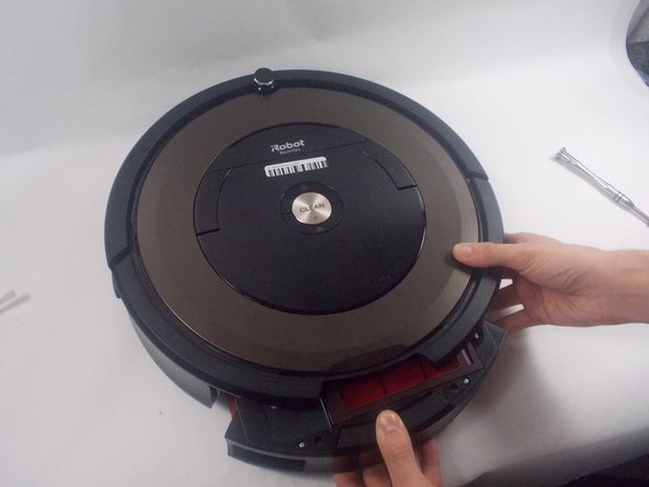

    • Turn Roomba face up.
    • Remove the dustbin by pressing the release button on the top side of the Roomba and pulling it straight out.

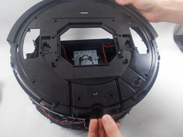

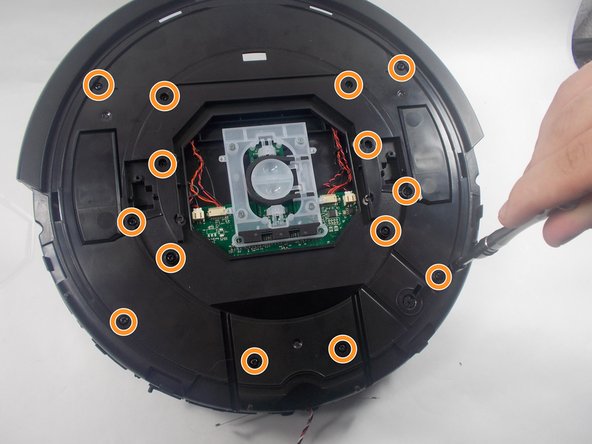

  7. iRobot Roomba 890 Charging Contacts Replacement: crwdns2935265:07crwdnd2935265:01crwdnd2935265:03crwdne2935265:0 iRobot Roomba 890 Charging Contacts Replacement: crwdns2935265:07crwdnd2935265:02crwdnd2935265:03crwdne2935265:0 iRobot Roomba 890 Charging Contacts Replacement: crwdns2935265:07crwdnd2935265:03crwdnd2935265:03crwdne2935265:0
    • Use a Phillips #1 screwdriver to remove the two 9.5 mm handle screws.
    • Use a Phillips #1 screwdriver to remove the fourteen 9.5 mm top plate screws.
    • Lift the top plate off.

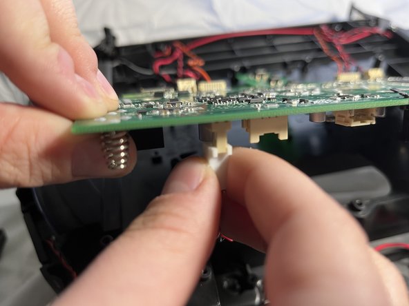

  8. iRobot Roomba 890 Charging Contacts Replacement: crwdns2935265:08crwdnd2935265:01crwdnd2935265:02crwdne2935265:0 iRobot Roomba 890 Charging Contacts Replacement: crwdns2935265:08crwdnd2935265:02crwdnd2935265:02crwdne2935265:0
    • Locate the charging contact wire connection to the motherboard.
    • Release the connector.
    • Pull gently on the white plug, not the wires themselves.
