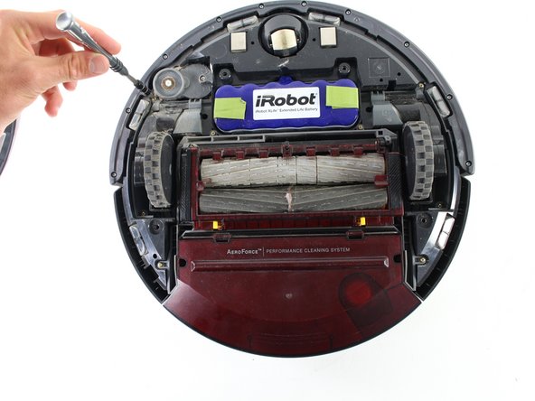

    • Turn the Roomba over so that the back side is facing up.
    • Using the Phillips #00 screwdriver, remove the 4.0mm screw in the center of the yellow side brush and lift the part out.

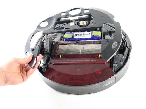

    • Use the Phillips #00 screwdriver to remove the four 3.5mm screws that hold down the battery panel and rear panel.
  3. iRobot Roomba 870 Side Brush Motor Replacement: crwdns2935265:03crwdnd2935265:01crwdnd2935265:02crwdne2935265:0 iRobot Roomba 870 Side Brush Motor Replacement: crwdns2935265:03crwdnd2935265:02crwdnd2935265:02crwdne2935265:0
    • First remove the battery panel, which is the small rectangular.
    • After removing the battery panel, remove the rear panel.

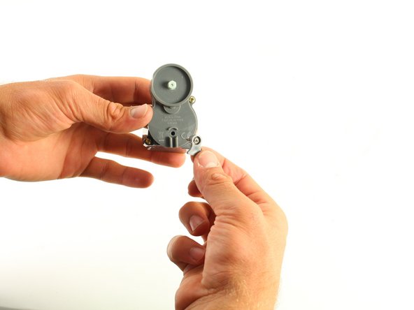

    • Remove the three small 3.5mm screws fastened to the motor housing.
    • After removing the screws, remove the motor housing from the rest of the Roomba.

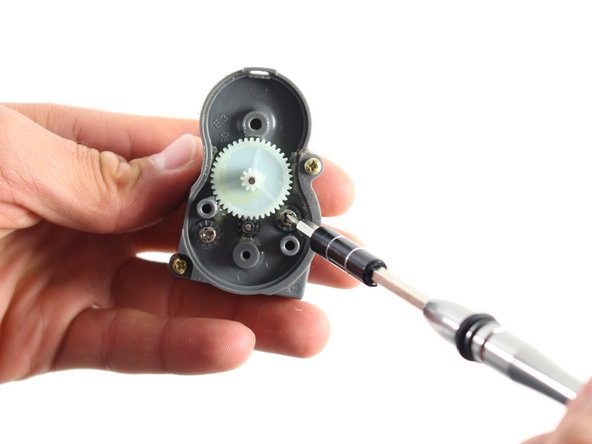

    • Remove the 2.5mm screw in the center of the motor housing using a Tri-Wing Y1 screwdriver.
    • After removing the screw, remove the top shell casing of the motor housing. Underneath, you will see a white gear with two screws next to it.
  6. iRobot Roomba 870 Side Brush Motor Replacement: crwdns2935265:06crwdnd2935265:01crwdnd2935265:03crwdne2935265:0 iRobot Roomba 870 Side Brush Motor Replacement: crwdns2935265:06crwdnd2935265:02crwdnd2935265:03crwdne2935265:0 iRobot Roomba 870 Side Brush Motor Replacement: crwdns2935265:06crwdnd2935265:03crwdnd2935265:03crwdne2935265:0

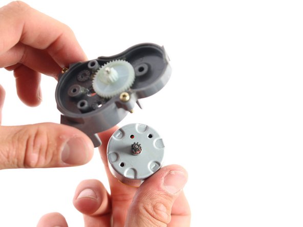

    • Remove the two 2.5mm screws in the inner motor housing using a Phillips #00 screwdriver.
    • After removing the two screws, the motor will slide right out the back, and it can be replaced.
