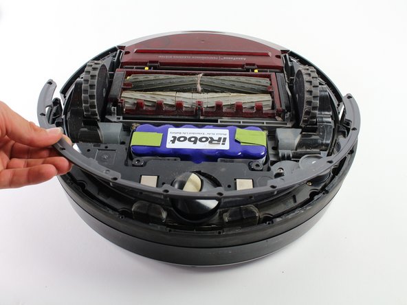

  4. iRobot Roomba 870  Bumper Sensor Replacement: crwdns2935265:04crwdnd2935265:01crwdnd2935265:03crwdne2935265:0 iRobot Roomba 870  Bumper Sensor Replacement: crwdns2935265:04crwdnd2935265:02crwdnd2935265:03crwdne2935265:0 iRobot Roomba 870  Bumper Sensor Replacement: crwdns2935265:04crwdnd2935265:03crwdnd2935265:03crwdne2935265:0
    • Remove the ten 3 mm screws that attach the bumper guard to the bumper with a Phillips #1 screwdriver.
    • Remove the bumper guard.

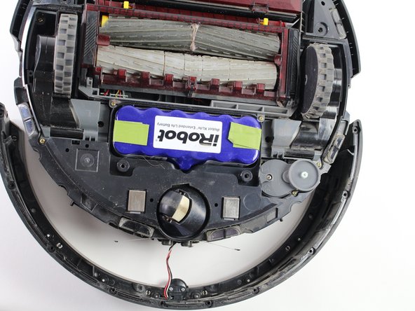

  5. iRobot Roomba 870  Bumper Sensor Replacement: crwdns2935265:05crwdnd2935265:01crwdnd2935265:02crwdne2935265:0 iRobot Roomba 870  Bumper Sensor Replacement: crwdns2935265:05crwdnd2935265:02crwdnd2935265:02crwdne2935265:0
    • Be careful when removing the bumper from the Roomba to prevent damage to the sensor wires. Remove slowly!
    • Lift up the Roomba so that its bumper is not resting on anything, and slowly separate the bumper from the device.

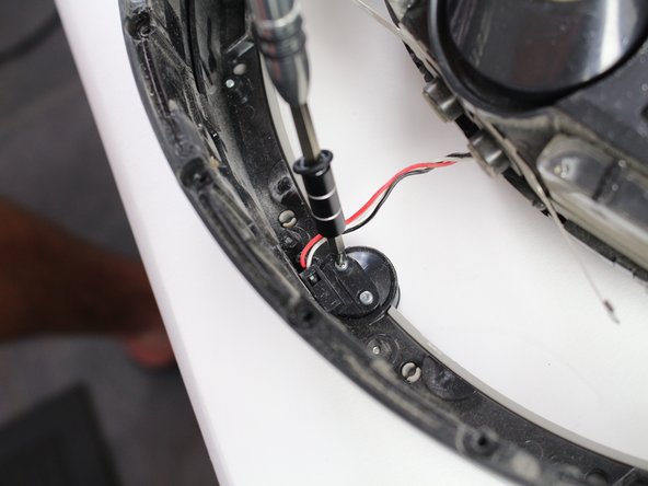

  6. iRobot Roomba 870  Bumper Sensor Replacement: crwdns2935265:06crwdnd2935265:01crwdnd2935265:03crwdne2935265:0 iRobot Roomba 870  Bumper Sensor Replacement: crwdns2935265:06crwdnd2935265:02crwdnd2935265:03crwdne2935265:0 iRobot Roomba 870  Bumper Sensor Replacement: crwdns2935265:06crwdnd2935265:03crwdnd2935265:03crwdne2935265:0
    • Remove the two 3 mm screws that attach the sensor connector to the bumper/sensor with a #1 Phillips Screwdriver.
    • Carefully detach the sensor connector from the bumper and the sensor.

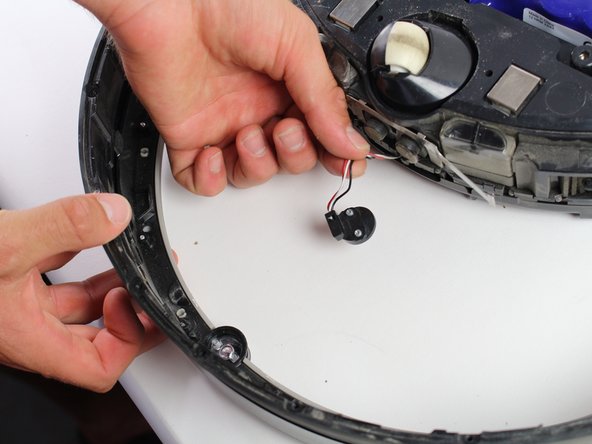

  7. iRobot Roomba 870  Bumper Sensor Replacement: crwdns2935265:07crwdnd2935265:01crwdnd2935265:02crwdne2935265:0 iRobot Roomba 870  Bumper Sensor Replacement: crwdns2935265:07crwdnd2935265:02crwdnd2935265:02crwdne2935265:0
    • The sensor is now loose on the bumper. Be careful not to rapidly move the bumper for fear of dislodging the sensor and breaking it.

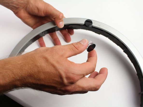

    • Flip the bumper over, ensuring the sensor remains inside the sensor compartment.
    • Gently remove the bumper from the black infrared sensor.
