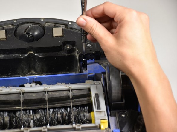

  6. iRobot Roomba 770 Main Wheels Replacement, Main Wheels: crwdns2935265:06crwdnd2935265:01crwdnd2935265:02crwdne2935265:0 iRobot Roomba 770 Main Wheels Replacement, Main Wheels: crwdns2935265:06crwdnd2935265:02crwdnd2935265:02crwdne2935265:0
    • Locate the three 15.5 mm screws surrounding each wheel. Use a J1 Philips screw driver to remove these.
    • The screw towards the center for each wheel may be hard to locate and may seem inaccessible. The head of your screw is long enough to reach it.
    • Use your J1 Philips screwdriver to remove these screws.
  7. iRobot Roomba 770 Main Wheels Replacement: crwdns2935265:07crwdnd2935265:01crwdnd2935265:02crwdne2935265:0 iRobot Roomba 770 Main Wheels Replacement: crwdns2935265:07crwdnd2935265:02crwdnd2935265:02crwdne2935265:0
    • Pull up on the wheels to remove them from the device.
