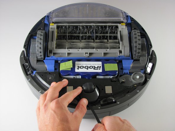

  3. iRobot Roomba 655 Pet Series Front Caster Wheel Replacement, Removal of Caster Wheel Housing: crwdns2935265:03crwdnd2935265:01crwdnd2935265:03crwdne2935265:0 iRobot Roomba 655 Pet Series Front Caster Wheel Replacement, Removal of Caster Wheel Housing: crwdns2935265:03crwdnd2935265:02crwdnd2935265:03crwdne2935265:0 iRobot Roomba 655 Pet Series Front Caster Wheel Replacement, Removal of Caster Wheel Housing: crwdns2935265:03crwdnd2935265:03crwdnd2935265:03crwdne2935265:0
    • Turn the Roomba upside down, so that the vacuum and wheels are facing the ceiling.
    • Hold the caster wheel housing steady and insert the plastic spudger under the wheel housing.
    • Apply some force to pry the caster wheel straight up out of the device, and remove the caster wheel housing from the Roomba.
  4. iRobot Roomba 655 Pet Series Front Caster Wheel Replacement, Removing Wheel From Rotating Housing: crwdns2935265:04crwdnd2935265:01crwdnd2935265:02crwdne2935265:0 iRobot Roomba 655 Pet Series Front Caster Wheel Replacement, Removing Wheel From Rotating Housing: crwdns2935265:04crwdnd2935265:02crwdnd2935265:02crwdne2935265:0
    • Firmly hold the caster wheel housing, and remove the caster wheel from its setting.
    • Clean the caster wheel with soap and water.
    • Once the caster wheel is clean and thoroughly dried, repeat the process in reverse order to reinstall the caster wheel back to the Roomba.
To reassemble the robot, follow these instructions in reverse order.
