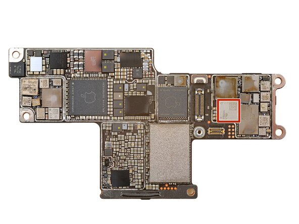

  1. iPhone Air Chip ID, Main Board - Outer Side: crwdns2935265:01crwdnd2935265:01crwdnd2935265:02crwdne2935265:0 iPhone Air Chip ID, Main Board - Outer Side: crwdns2935265:01crwdnd2935265:02crwdnd2935265:02crwdne2935265:0
    • Kioxia K8A7RJ5126 ? 256 GB NAND flash memory
    • NXP Semiconductors CBTL1701B0 USB Type-C port controller
    • Apple APL1064/338S01279 power management
    • Texas Instruments CP3200C1H3 battery charger
    • Apple/Cirrus Logic 338S00967 audio codec
    • Apple/Cirrus Logic 338S01148 audio amplifier
    • Broadcom BCM59367A1IUBG wireless charging controller
  2. iPhone Air Chip ID: crwdns2935265:02crwdnd2935265:01crwdnd2935265:01crwdne2935265:0
    • Qorvo QM81026H envelope tracker
  3. iPhone Air Chip ID, Main Board - Outer Side - Connectivity: crwdns2935265:03crwdnd2935265:01crwdnd2935265:01crwdne2935265:0
    • Apple APL1114/337S01030 5G modem
    • Apple APL1088/338S01150 RF transceiver
    • Skyworks SKY58452-14 front-end module
    • Broadcom AFEM-8254 front-end module
    • Broadcom AFEM-8255 front-end module
    • Broadcom AFEM-8277 front-end module
    • Skyworks SKY53921-16 front-end module
  4. iPhone Air Chip ID, Main Board - Outer Side - Sensors: crwdns2935265:04crwdnd2935265:01crwdnd2935265:01crwdne2935265:0
    • Bosch Sensortec accelerometer & gyroscope
  5. iPhone Air Chip ID, Main Board - Inner Side: crwdns2935265:05crwdnd2935265:01crwdnd2935265:02crwdne2935265:0 iPhone Air Chip ID, Main Board - Inner Side: crwdns2935265:05crwdnd2935265:02crwdnd2935265:02crwdne2935265:0
    • Apple APL1V12/339S01839 hexa-core applications processor w/ GPU & Neural Engine layered under a Samsung K3KLMLM0FM-HGGV 12 GB LPDDR5X SDRAM
    • Texas Instruments TPS65658A0 display power supply
    • Analog Devices MAX11390A analog to digital converter
    • Analog Devices MAX20348P DC-DC converter
    • Possibly Texas Instruments CP5100A0 camera flash controller
  6. iPhone Air Chip ID, Main Board - Inner Side - Connectivity: crwdns2935265:06crwdnd2935265:01crwdnd2935265:01crwdne2935265:0
    • USI ? 339M00400 WiFi 7, Bluetooth 6, and Thread Module (contains Apple N1)
  7. iPhone Air Chip ID, NFC Board: crwdns2935265:07crwdnd2935265:01crwdnd2935265:02crwdne2935265:0 iPhone Air Chip ID, NFC Board: crwdns2935265:07crwdnd2935265:02crwdnd2935265:02crwdne2935265:0
    • STMicroelectronics STPMIA3A power management
    • Likely STMicroelectronics STB605A11 power management
    • Apple 338S00616 DC-DC converter
  8. iPhone Air Chip ID, NFC Board - Connectivity: crwdns2935265:08crwdnd2935265:01crwdnd2935265:01crwdne2935265:0
    • NXP Semiconductors SN300 NFC controller w/ eSIM & secure element
    • Possibly NXP Semiconductors NFC controller
  9. iPhone Air Chip ID, UWB Board - Connectivity: crwdns2935265:09crwdnd2935265:01crwdnd2935265:02crwdne2935265:0 iPhone Air Chip ID, UWB Board - Connectivity: crwdns2935265:09crwdnd2935265:02crwdnd2935265:02crwdne2935265:0
    • USI ? 339M00384 UWB Module (contains Apple U2)
What about the thing above the A19? You didn't mentioned it.
boris_dg - crwdns2934203:0crwdne2934203:0
Probably because it is not that interesting. It's a shield which covers the main power supply.
