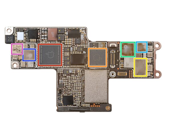

    3. iPhone Air Chip ID, Main Board - Outer Side - Connectivity: crwdns2935265:03crwdnd2935265:01crwdnd2935265:01crwdne2935265:0
      • Apple APL1114/337S01030 5G modem
      • Apple APL1088/338S01150 RF transceiver
      • Skyworks SKY58452-14 front-end module
      • Broadcom AFEM-8254 front-end module
      • Broadcom AFEM-8255 front-end module
      • Broadcom AFEM-8277 front-end module
      • Skyworks SKY53921-16 front-end module

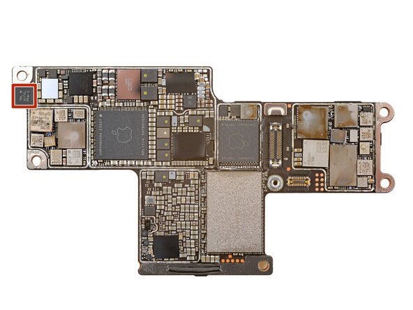

    4. iPhone Air Chip ID, Main Board - Outer Side - Sensors: crwdns2935265:04crwdnd2935265:01crwdnd2935265:01crwdne2935265:0
      • Bosch Sensortec accelerometer & gyroscope

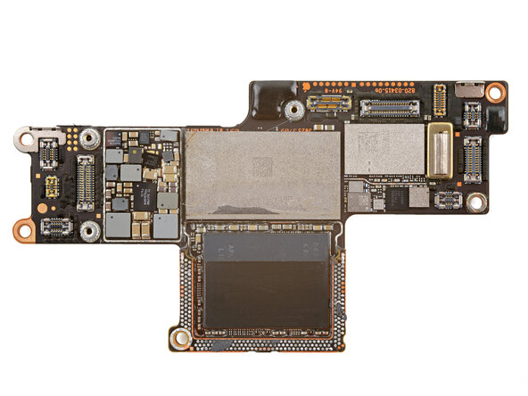

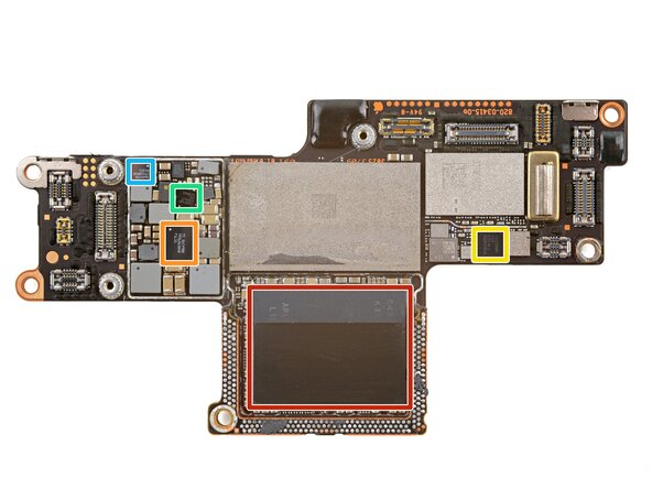

    5. iPhone Air Chip ID, Main Board - Inner Side: crwdns2935265:05crwdnd2935265:01crwdnd2935265:02crwdne2935265:0 iPhone Air Chip ID, Main Board - Inner Side: crwdns2935265:05crwdnd2935265:02crwdnd2935265:02crwdne2935265:0
      • Apple APL1V12/339S01839 hexa-core applications processor w/ GPU & Neural Engine layered under a Samsung K3KLMLM0FM-HGGV 12 GB LPDDR5X SDRAM
      • Texas Instruments TPS65658A0 display power supply
      • Analog Devices MAX11390A analog to digital converter
      • Analog Devices MAX20348P DC-DC converter
      • Possibly Texas Instruments CP5100A0 camera flash controller

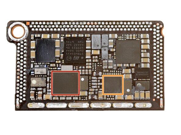

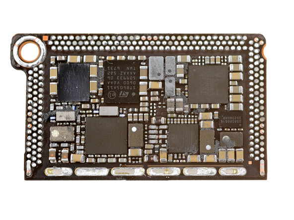

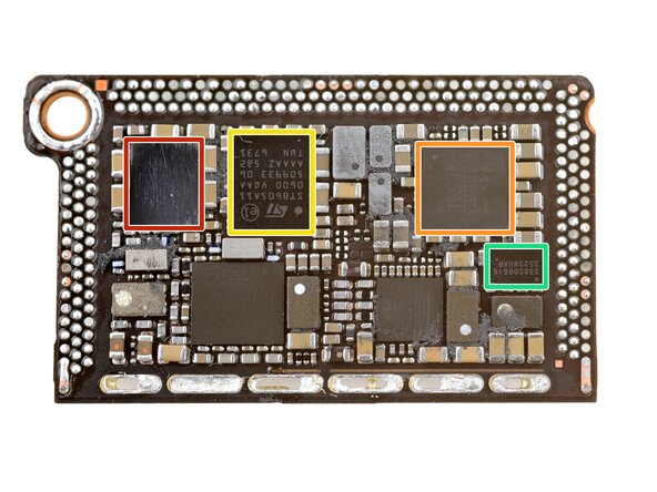

    7. iPhone Air Chip ID, NFC Board: crwdns2935265:07crwdnd2935265:01crwdnd2935265:02crwdne2935265:0 iPhone Air Chip ID, NFC Board: crwdns2935265:07crwdnd2935265:02crwdnd2935265:02crwdne2935265:0
      • Apple/Cirrus Logic 338S01148 audio amplifier
      • STMicroelectronics STPMIA3A power management
      • Likely STMicroelectronics STB605A11 power management
      • Apple 338S00616 DC-DC converter

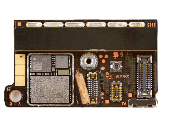

    8. iPhone Air Chip ID, NFC Board - Connectivity: crwdns2935265:08crwdnd2935265:01crwdnd2935265:01crwdne2935265:0
      • NXP Semiconductors SN300 NFC controller w/ eSIM & secure element
      • Possibly NXP Semiconductors NFC controller

What about the thing above the A19? You didn't mentioned it.
boris_dg - crwdns2934203:0crwdne2934203:0 crwdns2950251:0crwdne2950251:0
Probably because it is not that interesting. It's a shield which covers the main power supply.
