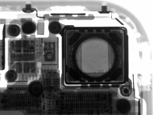

    • Before we excavate, we X-ray!
    • Our pals at Creative Electron came down under to Circuitwise and snagged some stellar sneak peek imagery.
    • The seamless back gives way to some intricate insides. The first thing we spy is the brand new wireless charging coil!
    • More on that later. For now, we put down the X-ray goggles to plan our attack.
    • Turns out you don't need X-ray vision to see the model number on this blank-backed phone—it's here on the rosy gold box—A1863!
    • It seems that when Apple set out to clean up the back of the iPhone, it decided to follow all the way through. We're guessing we won't find a cute ID card in the SIM tray, though.

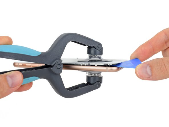

    • Time to get this teardown underway. After twirling away the pentalobe screws, we need some heat as an antidote to the waterproof display seals.
    • iOpener—bam! Seals softened. Next we pull the iSclack out of our tool bag for some pulling power, and slice through the adhesive with a little help from our friends opening picks.
    • Do you ever have déjà vu?
    • ... and we're in! A first glance reveals nothing new—yet. But we've only just scratched the glassy surface.
