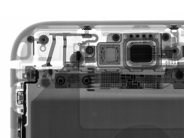

  3. iPhone 6s Plus Teardown: crwdns2935265:03crwdnd2935265:01crwdnd2935265:03crwdne2935265:0 iPhone 6s Plus Teardown: crwdns2935265:03crwdnd2935265:02crwdnd2935265:03crwdne2935265:0 iPhone 6s Plus Teardown: crwdns2935265:03crwdnd2935265:03crwdnd2935265:03crwdne2935265:0
    • Time for a sneak peek! As usual, we'll be blasting this iPhone with the power of see-through: our friends at Creative Electron brought their X-ray tech to the land down under.
    • iPhone, you better run, you better take cover.
    • Our engineers travelled to the upside-down land of Australia to bring you this live teardown, but we couldn't have done it with the hospitality of Macfixit and Circuitwise.
    • Now for the moment that you've been waiting for—let's get this teardown started!

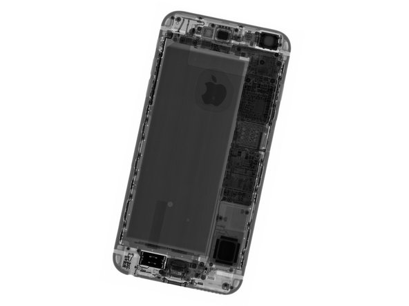

    • A quick blast of X-rays reveals the presence of some new silicon piggybacking onto the display—just like we found on the 6s.

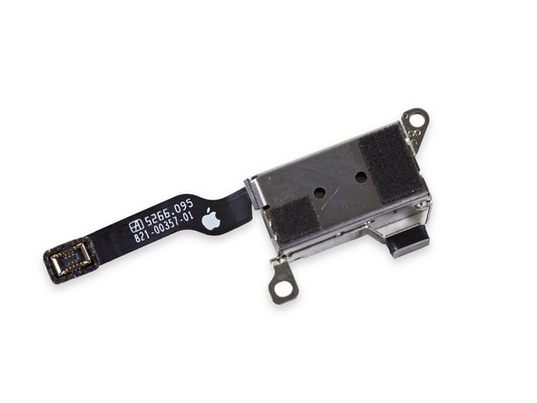

    • A new bracket secures the (bitty!) Taptic Engine and its new cable.
    • The Taptic Engine in the 6s Plus measures 15 x 8 x 4.9 mm compared to the 35 x 6 x 3.2 mm one found in the 6s.
    • Our guess as to the reason for the substantially smaller footprint: Apple didn't want to shave off too much from the already-scaled-down battery.
    • No question about it—it's a tight fit with everything assembled.
    • The Taptic Engine also has a lil' rubber bumper for bracing against the microphone.
    • We plopped the Taptic Engine back into place long enough for it to perform its signature move.
    • Little did it know, it was being watched.

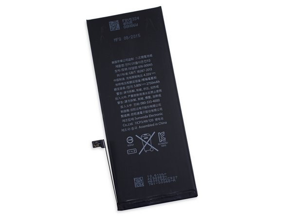

  8. iPhone 6s Plus Teardown: crwdns2935265:09crwdnd2935265:01crwdnd2935265:03crwdne2935265:0 iPhone 6s Plus Teardown: crwdns2935265:09crwdnd2935265:02crwdnd2935265:03crwdne2935265:0 iPhone 6s Plus Teardown: crwdns2935265:09crwdnd2935265:03crwdnd2935265:03crwdne2935265:0
    • Moving on to the battery, we're greeted with a few familiar friends—adhesive pull tabs.
    • Never stop being awesome, adhesive pull tabs. Never.
    • Much like the 6 Plus before it, removing the battery is as easy as pulling 3 tabs. Well, as long as you pull them exactly right.
    • The battery capacity sits at 2750 mAh (10.45 Wh); a modest 165 mAh downgrade compared to last year's 6 Plus.
    • Despite the downgrade, Apple claims battery life will be comparable to that of the 6 Plus—that is, 14 hours of 3G talk time, approximately 10 hours of internet use, or up to 10 days on standby.

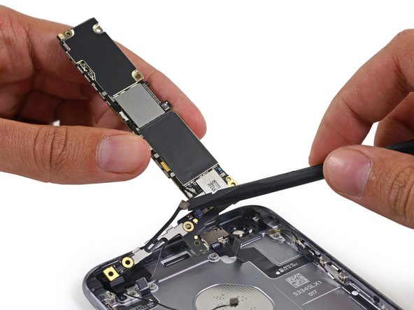

    • The next stage of the game involves removing the logic board.
    • With the skill of a blackjack dealer, we send the cards cables flying and boards flipping.
    • You're going to need to channel your inner card shark to get this logic board out. Removing the final connector requires you to flip the logic board over—not a big problem, but a bit annoying.
    • We shuffle the logic board out of the case for a closer look. We like to have lots of chips on our (teardown) table...

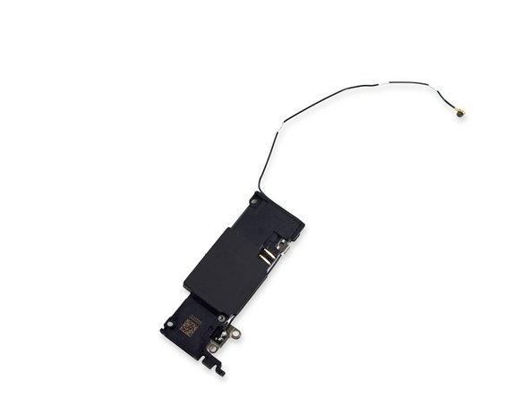

  16. iPhone 6s Plus Teardown: crwdns2935265:017crwdnd2935265:01crwdnd2935265:03crwdne2935265:0 iPhone 6s Plus Teardown: crwdns2935265:017crwdnd2935265:02crwdnd2935265:03crwdne2935265:0 iPhone 6s Plus Teardown: crwdns2935265:017crwdnd2935265:03crwdnd2935265:03crwdne2935265:0
    • Reaching the deepest depths of the 6s Plus, we come across the speaker and its little antenna buddy.
    • As in the 6s, we find a very similar speaker to that of the original 6 Plus—a slightly modified form factor, but otherwise seemingly untouched.
