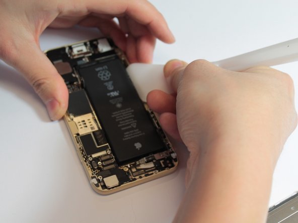

  4. iPhone 6 Teardown: crwdns2935265:04crwdnd2935265:01crwdnd2935265:02crwdne2935265:0 iPhone 6 Teardown: crwdns2935265:04crwdnd2935265:02crwdnd2935265:02crwdne2935265:0
    • The battery is very well stuck in. With a bit of heat and a little deformation of the battery, we were able to get it out. (There's probably a pull tab to remove the battery, but we didn't find it.)
    • The battery is rated at 3.82V, 6.91Whr.

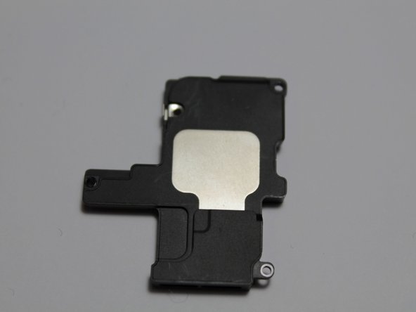

  9. iPhone 6 Teardown: crwdns2935265:09crwdnd2935265:01crwdnd2935265:01crwdne2935265:0
    • The loudspeaker.

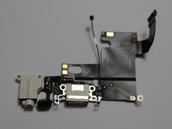

  10. iPhone 6 Teardown: crwdns2935265:010crwdnd2935265:01crwdnd2935265:01crwdne2935265:0
    • The Lightning port.

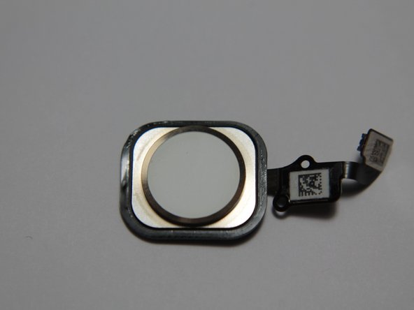

  11. iPhone 6 Teardown: crwdns2935265:011crwdnd2935265:01crwdnd2935265:01crwdne2935265:0
    • The Touch ID sensor.

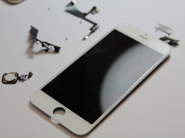

  12. iPhone 6 Teardown: crwdns2935265:012crwdnd2935265:01crwdnd2935265:01crwdne2935265:0
    • The front camera and proximity sensor flex cable.
  13. iPhone 6 Teardown: crwdns2935265:013crwdnd2935265:01crwdnd2935265:03crwdne2935265:0 iPhone 6 Teardown: crwdns2935265:013crwdnd2935265:02crwdnd2935265:03crwdne2935265:0 iPhone 6 Teardown: crwdns2935265:013crwdnd2935265:03crwdnd2935265:03crwdne2935265:0
    • The iPhone 6 display assembly. It's thinner than the iPhone 5s/5c/5 screen.
    • The Touch ID Cable runs from the home switch to the top of the screen, adding a 4th connector at the top.

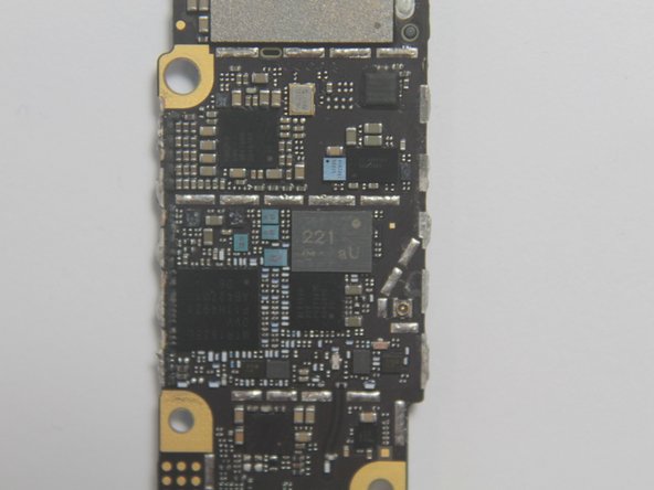

  14. iPhone 6 Teardown: crwdns2935265:014crwdnd2935265:01crwdnd2935265:03crwdne2935265:0 iPhone 6 Teardown: crwdns2935265:014crwdnd2935265:02crwdnd2935265:03crwdne2935265:0 iPhone 6 Teardown: crwdns2935265:014crwdnd2935265:03crwdnd2935265:03crwdne2935265:0
    • After the usual painful desoldering of the shielding, we have the logic board in all its naked glory.
    • Analysis to follow with iFixit's full teardown.
