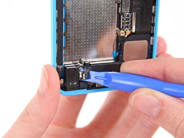

    1. iPhone 5c Lightning Connector Assembly Replacement, Lightning Connector Assembly: crwdns2935265:026crwdnd2935265:01crwdnd2935265:02crwdne2935265:0 iPhone 5c Lightning Connector Assembly Replacement, Lightning Connector Assembly: crwdns2935265:026crwdnd2935265:02crwdnd2935265:02crwdne2935265:0
      • Use a plastic opening tool to peel the home button spring contact cable up from the speaker enclosure.

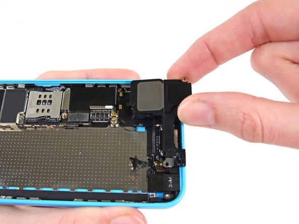

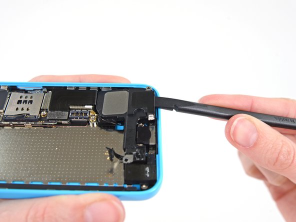

    3. iPhone 5c Lightning Connector Assembly Replacement: crwdns2935265:028crwdnd2935265:01crwdnd2935265:02crwdne2935265:0 iPhone 5c Lightning Connector Assembly Replacement: crwdns2935265:028crwdnd2935265:02crwdnd2935265:02crwdne2935265:0
      • Use the flat end of a spudger to gently pry the speaker enclosure up from the rear case.
    4. iPhone 5c Lightning Connector Assembly Replacement: crwdns2935265:029crwdnd2935265:01crwdnd2935265:02crwdne2935265:0 iPhone 5c Lightning Connector Assembly Replacement: crwdns2935265:029crwdnd2935265:02crwdnd2935265:02crwdne2935265:0
      • Remove the speaker enclosure. Be careful not to snag it on the antenna cable.

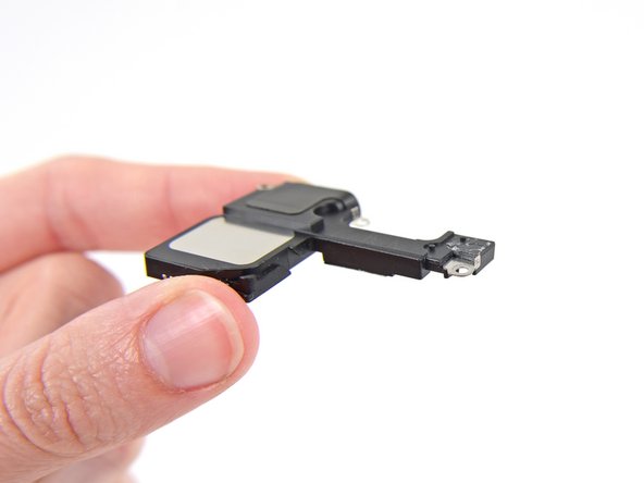

    5. iPhone 5c Lightning Connector Assembly Replacement: crwdns2935265:030crwdnd2935265:01crwdnd2935265:02crwdne2935265:0 iPhone 5c Lightning Connector Assembly Replacement: crwdns2935265:030crwdnd2935265:02crwdnd2935265:02crwdne2935265:0
      • The far right screw hole on the speaker has a contact bracket wrapped around it. This small part may fall off unexpectedly, so it's best to remove it and note the orientation for reassembly.
      • The flat portion of the contact clip should rest against the speaker, as shown.
      • The alignment bracket on the far end of the speaker assembly is adhered, but may fall off if handled aggressively.
      • The angled end should face up and line up with the outside edge of the speaker.

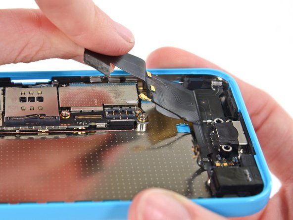

    6. iPhone 5c Lightning Connector Assembly Replacement: crwdns2935265:031crwdnd2935265:01crwdnd2935265:01crwdne2935265:0
      • Use a plastic opening tool to disconnect the Lightning connector ribbon cable from its socket on the logic board.
    7. iPhone 5c Lightning Connector Assembly Replacement: crwdns2935265:032crwdnd2935265:01crwdnd2935265:02crwdne2935265:0 iPhone 5c Lightning Connector Assembly Replacement: crwdns2935265:032crwdnd2935265:02crwdnd2935265:02crwdne2935265:0
      • The Lightning connector cable is lightly adhered to a shield on the logic board. Use the flat end of a spudger to gently peel the cable up.

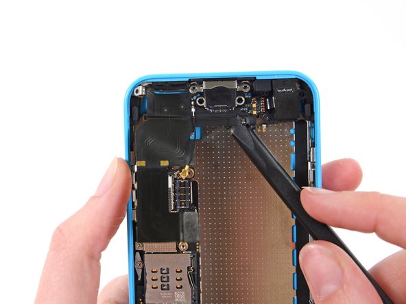

    8. iPhone 5c Lightning Connector Assembly Replacement: crwdns2935265:033crwdnd2935265:01crwdnd2935265:01crwdne2935265:0
      • Disconnect the cellular antenna connector from the base of the logic board.

      • Gently peel the Lightning connector assembly up from the rear case.
    11. iPhone 5c Lightning Connector Assembly Replacement: crwdns2935265:036crwdnd2935265:01crwdnd2935265:02crwdne2935265:0 iPhone 5c Lightning Connector Assembly Replacement: crwdns2935265:036crwdnd2935265:02crwdnd2935265:02crwdne2935265:0
      • You may need to use the flat end of a spudger to completely free the assembly.
    12. iPhone 5c Lightning Connector Assembly Replacement: crwdns2935265:037crwdnd2935265:01crwdnd2935265:02crwdne2935265:0 iPhone 5c Lightning Connector Assembly Replacement: crwdns2935265:037crwdnd2935265:02crwdnd2935265:02crwdne2935265:0
      • Remove the Lightning connector assembly.
      • There is a small rubber gasket attached to the microphone. Be sure to transfer it to the new assembly.
