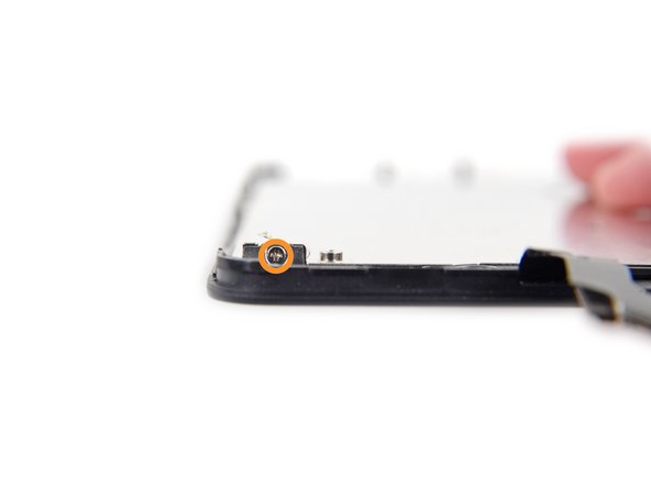

    1. iPhone 5c LCD and Digitizer Replacement, LCD and Digitizer: crwdns2935265:029crwdnd2935265:01crwdnd2935265:02crwdne2935265:0 iPhone 5c LCD and Digitizer Replacement, LCD and Digitizer: crwdns2935265:029crwdnd2935265:02crwdnd2935265:02crwdne2935265:0
      • Remove two 1.2 mm Phillips #000 screws from each side of the LCD frame (four total).
    2. iPhone 5c LCD and Digitizer Replacement: crwdns2935265:030crwdnd2935265:01crwdnd2935265:02crwdne2935265:0 iPhone 5c LCD and Digitizer Replacement: crwdns2935265:030crwdnd2935265:02crwdnd2935265:02crwdne2935265:0
      • Remove the 1.6 mm Phillips #000 screws from the LCD shield plate.
      • One at bottom of the display assembly near the home button opening
      • One at the top of the display near the cables
