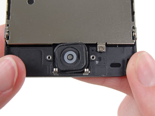

    1. iPhone 5c Home Button Replacement, Home Button: crwdns2935265:020crwdnd2935265:01crwdnd2935265:02crwdne2935265:0 iPhone 5c Home Button Replacement, Home Button: crwdns2935265:020crwdnd2935265:02crwdnd2935265:02crwdne2935265:0
      • Gently push the top right corner of the home button up away from the front panel.
      • Do not push the home button all the way through; you only need to get a corner free so that you can pry it out with a spudger.
      • This membrane is very thin. If you feel like you are going to tear the button, apply heat and try again.
    2. iPhone 5c Home Button Replacement: crwdns2935265:021crwdnd2935265:01crwdnd2935265:01crwdne2935265:0
      • Peel the home button the rest of the way off of the display by prying gently with a spudger.
    3. iPhone 5c Home Button Replacement: crwdns2935265:022crwdnd2935265:01crwdnd2935265:01crwdne2935265:0
      • Remove the home button assembly from the front panel.
