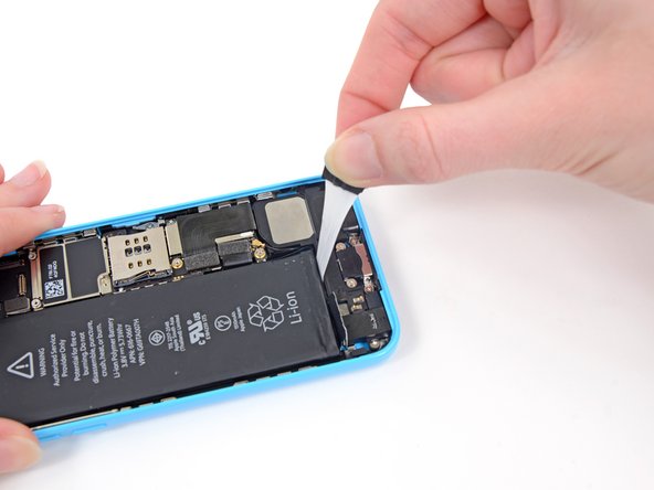

    1. iPhone 5c Battery Replacement, Battery: crwdns2935265:017crwdnd2935265:01crwdnd2935265:03crwdne2935265:0 iPhone 5c Battery Replacement, Battery: crwdns2935265:017crwdnd2935265:02crwdnd2935265:03crwdne2935265:0 iPhone 5c Battery Replacement, Battery: crwdns2935265:017crwdnd2935265:03crwdnd2935265:03crwdne2935265:0
      • Run the tip of a spudger between the battery and the headphone jack to unfold the battery adhesive tab.
    2. iPhone 5c Battery Replacement: crwdns2935265:018crwdnd2935265:01crwdnd2935265:01crwdne2935265:0
      • Pull the battery adhesive tab away from the phone.
    3. iPhone 5c Battery Replacement: crwdns2935265:019crwdnd2935265:01crwdnd2935265:02crwdne2935265:0 iPhone 5c Battery Replacement: crwdns2935265:019crwdnd2935265:02crwdnd2935265:02crwdne2935265:0
      • Cut the black battery adhesive tab between the two white adhesive strips, separating them.
    4. iPhone 5c Battery Replacement: crwdns2935265:020crwdnd2935265:01crwdnd2935265:02crwdne2935265:0 iPhone 5c Battery Replacement: crwdns2935265:020crwdnd2935265:02crwdnd2935265:02crwdne2935265:0
      • Try to keep the strips flat and unwrinkled during this procedure; wrinkled strips will stick together and break instead of pulling out cleanly.
      • Slowly pull one of the battery adhesive strips away from the battery, toward the bottom of the iPhone.
      • Pull steadily, maintaining constant tension on the strip as it slips out from between the battery and the rear case. For best results, pull the strip at a 60º angle or less.
      • Guide the strip carefully around the corner and up the side of the battery. Be careful not to snag it on any of the other internal iPhone components.
      • The strip will stretch to many times its original length. Continue pulling, re-grabbing the strip near the battery if necessary, until the entire strip comes free.
    5. iPhone 5c Battery Replacement: crwdns2935265:021crwdnd2935265:01crwdnd2935265:02crwdne2935265:0 iPhone 5c Battery Replacement: crwdns2935265:021crwdnd2935265:02crwdnd2935265:02crwdne2935265:0
      • Repeat to remove the second strip.
    6. iPhone 5c Battery Replacement: crwdns2935265:022crwdnd2935265:01crwdnd2935265:01crwdne2935265:0
      • Remove the battery from your iPhone.
      • If one, or both, of the adhesive strips tears, and you are unable to retrieve it with a set of tweezers, do not pry the battery out of the phone. Continue on to the next steps to safely remove your battery.
