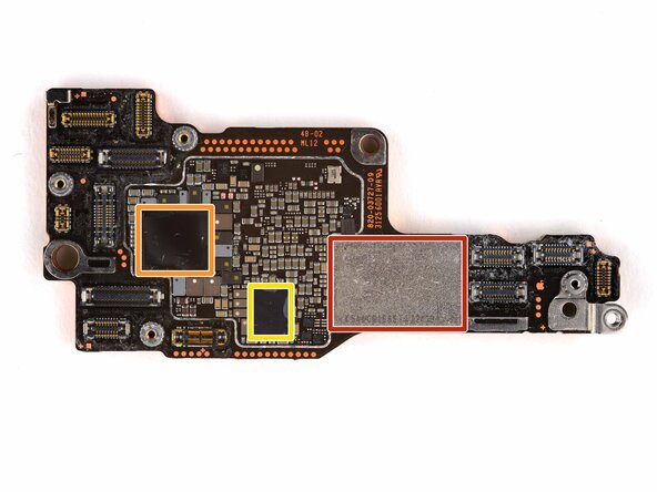

    1. iPhone 17 Pro Chip ID, Processor Board - Outer Side: crwdns2935265:01crwdnd2935265:01crwdnd2935265:02crwdne2935265:0 iPhone 17 Pro Chip ID, Processor Board - Outer Side: crwdns2935265:01crwdnd2935265:02crwdnd2935265:02crwdne2935265:0
      • Kioxia K5A4CG1685 ? 256 GB NAND flash memory
      • Apple APL10xx ?/338S00x05 ? power management
      • Likely Apple/Cirrus Logic 338S00843 power management

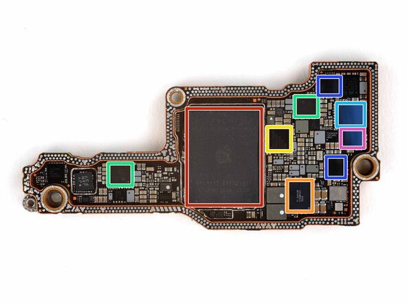

    2. iPhone 17 Pro Chip ID, Processor Board - Inner Side: crwdns2935265:02crwdnd2935265:01crwdnd2935265:02crwdne2935265:0 iPhone 17 Pro Chip ID, Processor Board - Inner Side: crwdns2935265:02crwdnd2935265:02crwdnd2935265:02crwdne2935265:0
      • Apple APL1V12/339S01837 A19 Pro hexa-core applications processor w/ GPU & Neural Engine layered under a Samsung K3KLMLM0FM-HGGV 12 GB LPDDR5X SDRAM
      • Texas Instruments CP3200C1K4 battery charger
      • NXP Semiconductors CBTL1701B0 USB Type-C port controller
      • STMicroelectronics STPMIA3A power management
      • Apple/Cirrus Logic 338S00967 audio codec
      • Apple/Cirrus Logic 338S01087 audio amplifier
      • Apple/Cirrus Logic 338S01148 audio amplifier

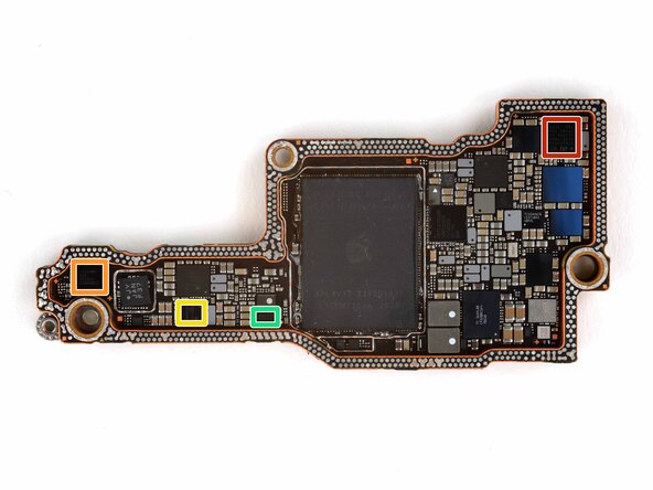

    3. iPhone 17 Pro Chip ID: crwdns2935265:03crwdnd2935265:01crwdnd2935265:01crwdne2935265:0
      • Likely STMicroelectronics STB605A11 power management
      • Analog Devices MAX11390A analog to digital converter
      • Apple 338S01153-B1 power management
      • Apple 338S00616 DC-DC converter

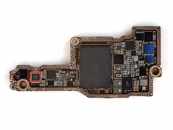

    4. iPhone 17 Pro Chip ID, Processor Board - Inner Side - Sensors: crwdns2935265:04crwdnd2935265:01crwdnd2935265:01crwdne2935265:0
      • Bosch Sensortec accelerometer & gyroscope

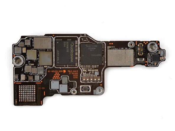

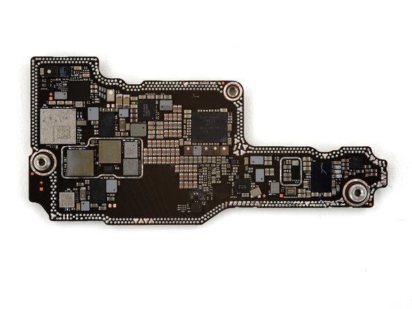

    5. iPhone 17 Pro Chip ID, RF Board - Outer Side: crwdns2935265:05crwdnd2935265:01crwdnd2935265:02crwdne2935265:0 iPhone 17 Pro Chip ID, RF Board - Outer Side: crwdns2935265:05crwdnd2935265:02crwdnd2935265:02crwdne2935265:0
      • Analog Devices MAX20348P DC-DC converter

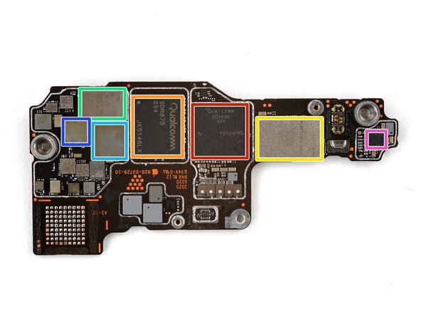

    6. iPhone 17 Pro Chip ID, RF Board - Outer Side - Connectivity: crwdns2935265:06crwdnd2935265:01crwdnd2935265:01crwdne2935265:0
      • Qualcomm SDX80M-001 5G Modem
      • Qualcomm SDR875-004 RF transceiver
      • USI 339M00399 WiFi 7/Bluetooth 6/Thread module (contains Apple N1)
      • Skyworks SKY58480-14 front-end module
      • Broadcom AFEM-8257 front-end module
      • Qorvo QM76309 front-end module
      • Possibly NXP Semiconductors NFC controller

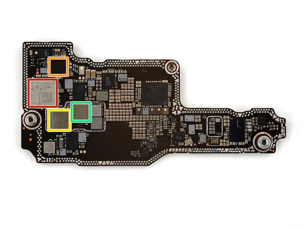

    7. iPhone 17 Pro Chip ID, RF Board - Inner Side: crwdns2935265:07crwdnd2935265:01crwdnd2935265:02crwdne2935265:0 iPhone 17 Pro Chip ID, RF Board - Inner Side: crwdns2935265:07crwdnd2935265:02crwdnd2935265:02crwdne2935265:0
      • Broadcom BCM59367A1IUBG wireless charging controller
      • Qualcomm PMX75-001 power management
      • Texas Instruments TPS65658A0 display power supply
      • Qualcomm QET7100A-002 wideband envelope tracker
      • Possibly Texas Instruments CP5100A0 camera flash controller

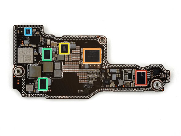

    8. iPhone 17 Pro Chip ID, RF Board - Inner Side - Connectivity: crwdns2935265:08crwdnd2935265:01crwdnd2935265:01crwdne2935265:0
      • Likely USI 339M00386 ultra-wideband module (contains Apple U2)
      • NXP Semiconductors SN300 NFC controller w/ eSIM & secure element
      • Broadcom AFEM-8267 front-end module
      • Qorvo QM76308 front-end module
