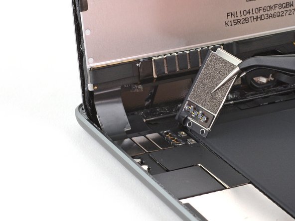

    4. iPad mini 5 Wi-Fi Screen Replacement, Disconnect the battery: crwdns2935265:027crwdnd2935265:01crwdnd2935265:02crwdne2935265:0 iPad mini 5 Wi-Fi Screen Replacement, Disconnect the battery: crwdns2935265:027crwdnd2935265:02crwdnd2935265:02crwdne2935265:0
      • The battery press connector is attached to the underside of the display cable bracket on the screw hole side.
      • Insert the flat end of a spudger under the display cable bracket and lift up to disconnect the battery press connector from the logic board.
      • Take care to pry only under the edge of the connector to prevent damaging the socket itself and surrounding components.
      • To re-attach press connectors like this one, carefully align and press down on one side until it clicks into place, then repeat on the other side. Do not press down on the middle. If the connector is misaligned, the pins can bend, causing permanent damage.
      • Don't try to remove the display cable bracket as it's attached to the battery by the battery cable.

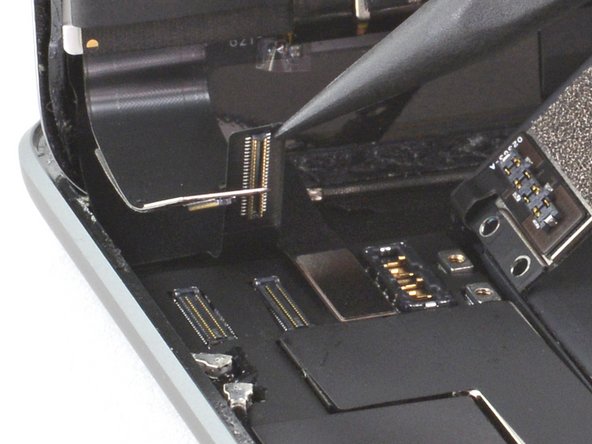

    6. iPad mini 5 Wi-Fi Screen Replacement, Disconnect the display press connectors: crwdns2935265:029crwdnd2935265:01crwdnd2935265:02crwdne2935265:0 iPad mini 5 Wi-Fi Screen Replacement, Disconnect the display press connectors: crwdns2935265:029crwdnd2935265:02crwdnd2935265:02crwdne2935265:0
      • Use the pointed end of a spudger to disconnect the digitizer press connector from the logic board.

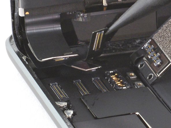

    7. iPad mini 5 Wi-Fi Screen Replacement: crwdns2935265:030crwdnd2935265:01crwdnd2935265:03crwdne2935265:0 iPad mini 5 Wi-Fi Screen Replacement: crwdns2935265:030crwdnd2935265:02crwdnd2935265:03crwdne2935265:0 iPad mini 5 Wi-Fi Screen Replacement: crwdns2935265:030crwdnd2935265:03crwdnd2935265:03crwdne2935265:0
      • Use the pointed end of a spudger to disconnect the second and third display press connectors.
    8. iPad mini 5 Wi-Fi Screen Replacement, Remove the screen: crwdns2935265:031crwdnd2935265:01crwdnd2935265:01crwdne2935265:0

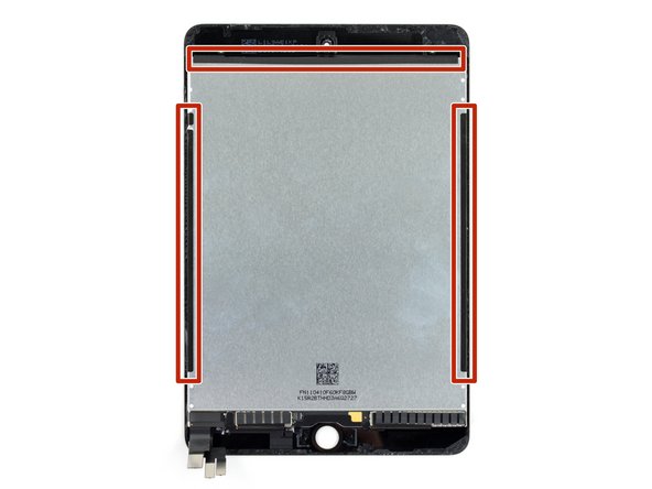

    9. iPad mini 5 Wi-Fi Screen Replacement, Screen reassembly information: crwdns2935265:032crwdnd2935265:01crwdnd2935265:03crwdne2935265:0 iPad mini 5 Wi-Fi Screen Replacement, Screen reassembly information: crwdns2935265:032crwdnd2935265:02crwdnd2935265:03crwdne2935265:0 iPad mini 5 Wi-Fi Screen Replacement, Screen reassembly information: crwdns2935265:032crwdnd2935265:03crwdnd2935265:03crwdne2935265:0
      • During reassembly, remove any remaining adhesive and residue from the perimeters of the frame and the screen. Then, apply new adhesive to secure the screen to the frame.
      • Don't remove the black tape on the left, right, and upper edges of the display. These hold the display to the front glass.
      • Follow this guide if you are using a pre-cut adhesive card. Follow this guide if you are using custom-cut adhesives.

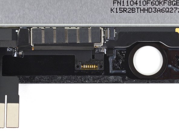

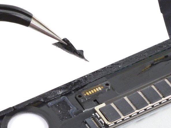

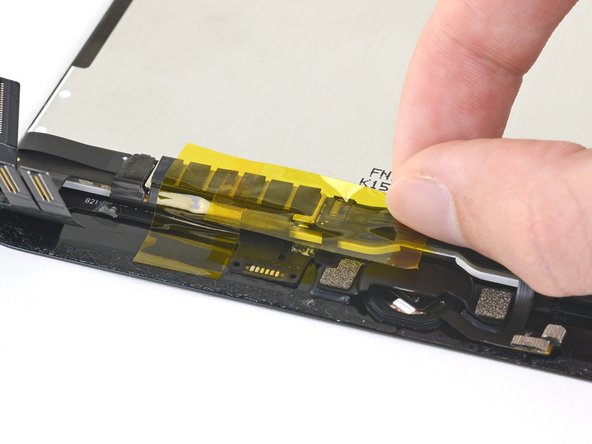

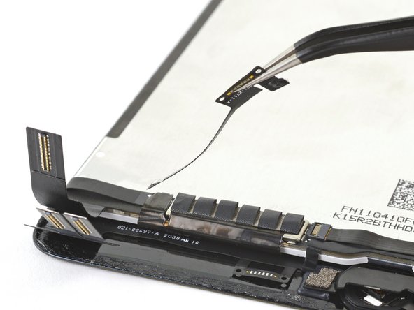

    1. iPad mini 5 Wi-Fi Screen Replacement, Remove the ZIF connector sticker: crwdns2935265:033crwdnd2935265:01crwdnd2935265:02crwdne2935265:0 iPad mini 5 Wi-Fi Screen Replacement, Remove the ZIF connector sticker: crwdns2935265:033crwdnd2935265:02crwdnd2935265:02crwdne2935265:0
      • Use a pair of tweezers to remove the sticker covering the home button assembly ZIF connector.

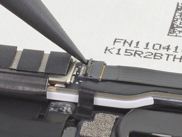

    2. iPad mini 5 Wi-Fi Screen Replacement, Unlock the ZIF connector: crwdns2935265:034crwdnd2935265:01crwdnd2935265:02crwdne2935265:0 iPad mini 5 Wi-Fi Screen Replacement, Unlock the ZIF connector: crwdns2935265:034crwdnd2935265:02crwdnd2935265:02crwdne2935265:0
      • Use the pointed end of a spudger, an opening tool, or your fingernail to flip up the small, hinged locking flap on the home button assembly ZIF connector.

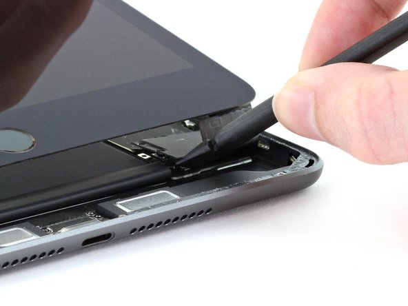

    3. iPad mini 5 Wi-Fi Screen Replacement, Unplug the home button assembly ZIF connector: crwdns2935265:035crwdnd2935265:01crwdnd2935265:02crwdne2935265:0 iPad mini 5 Wi-Fi Screen Replacement, Unplug the home button assembly ZIF connector: crwdns2935265:035crwdnd2935265:02crwdnd2935265:02crwdne2935265:0
      • Use a pair of tweezers to pull the home button assembly cable out of the ZIF connector.

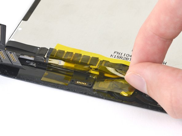

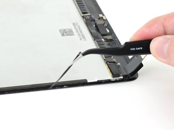

    4. iPad mini 5 Wi-Fi Screen Replacement, Separate the home button assembly cable: crwdns2935265:036crwdnd2935265:01crwdnd2935265:02crwdne2935265:0 iPad mini 5 Wi-Fi Screen Replacement, Separate the home button assembly cable: crwdns2935265:036crwdnd2935265:02crwdnd2935265:02crwdne2935265:0
      • The home button assembly cable is secured to the screen with light adhesive.
      • Use an opening pick to separate the home button assembly cable from the screen.

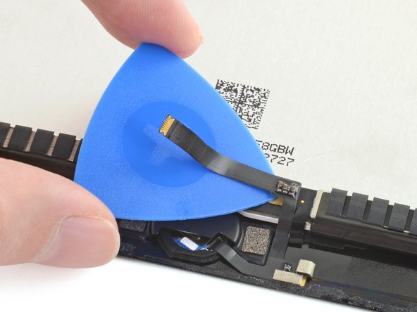

    5. iPad mini 5 Wi-Fi Screen Replacement: crwdns2935265:037crwdnd2935265:01crwdnd2935265:03crwdne2935265:0 iPad mini 5 Wi-Fi Screen Replacement: crwdns2935265:037crwdnd2935265:02crwdnd2935265:03crwdne2935265:0 iPad mini 5 Wi-Fi Screen Replacement: crwdns2935265:037crwdnd2935265:03crwdnd2935265:03crwdne2935265:0
      • Use an opening pick to continue separating the home button assembly cable from the screen.

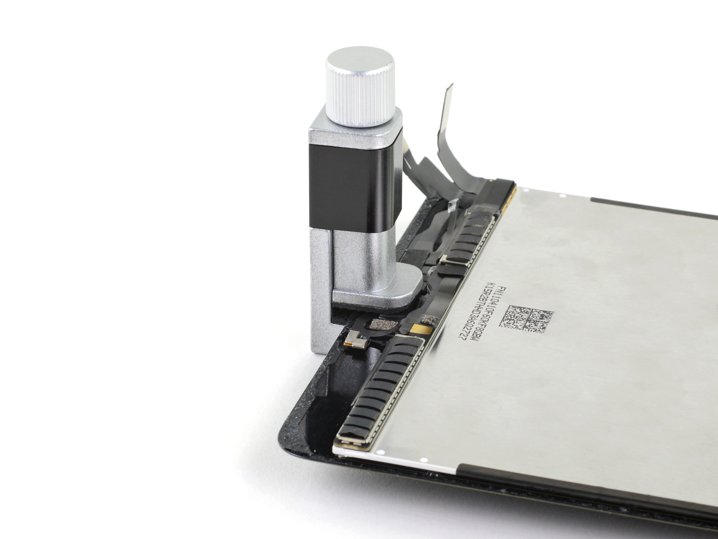

    6. iPad mini 5 Wi-Fi Screen Replacement, Pry off the home button bracket: crwdns2935265:038crwdnd2935265:01crwdnd2935265:03crwdne2935265:0 iPad mini 5 Wi-Fi Screen Replacement, Pry off the home button bracket: crwdns2935265:038crwdnd2935265:02crwdnd2935265:03crwdne2935265:0 iPad mini 5 Wi-Fi Screen Replacement, Pry off the home button bracket: crwdns2935265:038crwdnd2935265:03crwdnd2935265:03crwdne2935265:0
      E6000 Adhesive Glue
      $2.99
      • Use a plastic opening tool to pry the home button bracket off of the screen.
      • Use a pair of tweezers to lift and remove the home button bracket.
      • When reinstalling this bracket, use high bond glue such as E6000 to secure it to the screen.
      • Use a small clamp to hold the bracket to the screen during the curing duration.
      • Make sure to support the other edges of the screen while clamping the bracket to avoid breaking the screen.

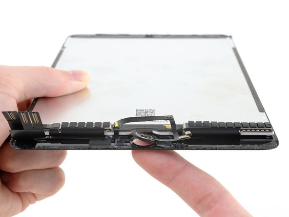

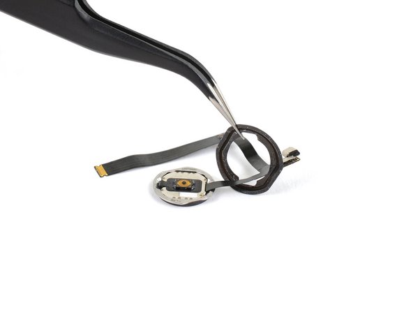

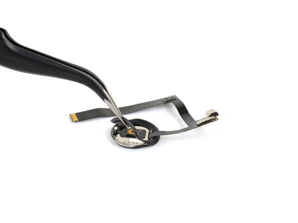

    8. iPad mini 5 Wi-Fi Screen Replacement, Remove the home button assembly: crwdns2935265:040crwdnd2935265:01crwdnd2935265:02crwdne2935265:0 iPad mini 5 Wi-Fi Screen Replacement, Remove the home button assembly: crwdns2935265:040crwdnd2935265:02crwdnd2935265:02crwdne2935265:0
      • The home button is held in place by a thin, delicate rubber gasket that is lightly adhered to the screen.
      • Slowly push the home button up and out through the back of the screen.
      • The home button will be hot. Wait until it's cool enough to touch before pushing it up.

      • Lift and remove the home button assembly.
      • You can reuse the home button gasket if it's sufficiently tacky. Otherwise, replace the black rubber gasket:
      • Peel the gasket off of the home button. Then, thread it past the cable to remove it.
      • Apply a replacement gasket to the home button.
      • The iPad mini 4's replacement gasket fits on the iPad mini 5, but it is slightly larger. Make sure it doesn't overlap the screen's adhesive so that the screen can be properly adhered to the frame.
      • To install the home button:
      • Rotate the home button so that the home button cable sits where it was before disassembly. Make sure the home button cable can be inserted into its ZIF connector.
      • Center the home button so that it fits into its slot in the screen. Then, press down firmly on the gasket to adhere it to the screen.
    1. iPad mini 5 Wi-Fi Screen Replacement, Remove the magnetic sensor sticker: crwdns2935265:042crwdnd2935265:01crwdnd2935265:02crwdne2935265:0 iPad mini 5 Wi-Fi Screen Replacement, Remove the magnetic sensor sticker: crwdns2935265:042crwdnd2935265:02crwdnd2935265:02crwdne2935265:0
      • Use a pair of tweezers to remove the sticker covering the magnetic sensor solder pads.
    2. iPad mini 5 Wi-Fi Screen Replacement, Desolder information: crwdns2935265:043crwdnd2935265:01crwdnd2935265:02crwdne2935265:0 iPad mini 5 Wi-Fi Screen Replacement, Desolder information: crwdns2935265:043crwdnd2935265:02crwdnd2935265:02crwdne2935265:0
      • In the next steps, you'll desolder the six solder pads securing the magnetic sensor to the screen.
    3. iPad mini 5 Wi-Fi Screen Replacement, Apply polyimide tape: crwdns2935265:044crwdnd2935265:01crwdnd2935265:03crwdne2935265:0 iPad mini 5 Wi-Fi Screen Replacement, Apply polyimide tape: crwdns2935265:044crwdnd2935265:02crwdnd2935265:03crwdne2935265:0 iPad mini 5 Wi-Fi Screen Replacement, Apply polyimide tape: crwdns2935265:044crwdnd2935265:03crwdnd2935265:03crwdne2935265:0
      • Apply polyimide tape to the area around the magnetic sensor solder pads to protect the components from heat.
    4. iPad mini 5 Wi-Fi Screen Replacement, Apply heat: crwdns2935265:045crwdnd2935265:01crwdnd2935265:01crwdne2935265:0
      • Use a soldering iron or hot air gun to apply heat evenly to the six magnetic sensor solder pads.
    5. iPad mini 5 Wi-Fi Screen Replacement, Remove the magnetic sensor cable: crwdns2935265:046crwdnd2935265:01crwdnd2935265:02crwdne2935265:0 iPad mini 5 Wi-Fi Screen Replacement, Remove the magnetic sensor cable: crwdns2935265:046crwdnd2935265:02crwdnd2935265:02crwdne2935265:0
      • When the solder on the solder pads is melted, use a pair of tweezers to separate the magnetic sensor from the screen.
      • If the solder isn't melted, apply more heat and try again.
      • When the area is cool enough to touch, remove the polyimide tape.
      • Use a pair of tweezers to remove the magnetic sensor cable.
      • The magnetic sensor cable is secured to the screen with light adhesive. Remove the magenetic sensor cable slowly to avoid damaging the cable under it.
      • During reassembly, apply a piece of polyimide tape under the solder pads while soldering the magnetic sensor to avoid damaging the screen.
    1. iPad mini 5 Wi-Fi Screen Replacement, Only the screen remains: crwdns2935265:047crwdnd2935265:01crwdnd2935265:01crwdne2935265:0
      • After removing the home button and magnetic sensor, only the screen remains.
      • Note that this image shows the magnetic sensor still installed.
