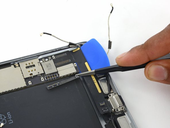

    • Run the pointed end of a spudger between the looped tape and the plastic cellular antenna housing to make it easier to peel the tape up.
  30. iPad mini 4 LTE Logic Board Replacement: crwdns2935265:030crwdnd2935265:01crwdnd2935265:03crwdne2935265:0 iPad mini 4 LTE Logic Board Replacement: crwdns2935265:030crwdnd2935265:02crwdnd2935265:03crwdne2935265:0 iPad mini 4 LTE Logic Board Replacement: crwdns2935265:030crwdnd2935265:03crwdnd2935265:03crwdne2935265:0
    • Use tweezers to peel up the looped tape adhered over the upper component cable bracket.

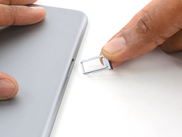

  33. iPad mini 4 LTE Logic Board Replacement, Logic Board: crwdns2935265:033crwdnd2935265:01crwdnd2935265:03crwdne2935265:0 iPad mini 4 LTE Logic Board Replacement, Logic Board: crwdns2935265:033crwdnd2935265:02crwdnd2935265:03crwdne2935265:0 iPad mini 4 LTE Logic Board Replacement, Logic Board: crwdns2935265:033crwdnd2935265:03crwdnd2935265:03crwdne2935265:0

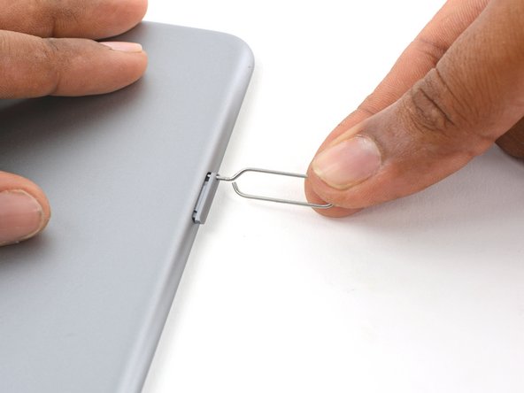

    • Press a paper clip or SIM eject tool into the SIM eject hole.
    • Remove the SIM card tray.

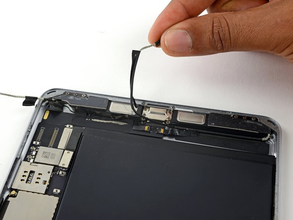

    • Use a spudger to disconnect the upper antenna interconnect cable from its socket on the logic board.
    • Lift the cable connector straight up from the board, do not pry on the socket itself.

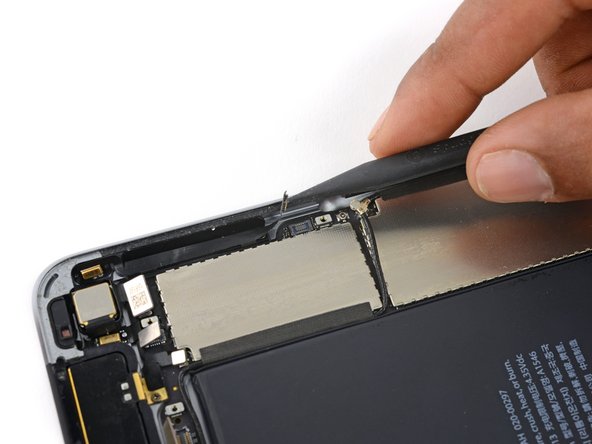

  35. iPad mini 4 LTE Logic Board Replacement: crwdns2935265:035crwdnd2935265:01crwdnd2935265:03crwdne2935265:0 iPad mini 4 LTE Logic Board Replacement: crwdns2935265:035crwdnd2935265:02crwdnd2935265:03crwdne2935265:0 iPad mini 4 LTE Logic Board Replacement: crwdns2935265:035crwdnd2935265:03crwdnd2935265:03crwdne2935265:0
    • Peel the upper antenna interconnect cable up off the logic board.
  36. iPad mini 4 LTE Logic Board Replacement: crwdns2935265:036crwdnd2935265:01crwdnd2935265:03crwdne2935265:0 iPad mini 4 LTE Logic Board Replacement: crwdns2935265:036crwdnd2935265:02crwdnd2935265:03crwdne2935265:0 iPad mini 4 LTE Logic Board Replacement: crwdns2935265:036crwdnd2935265:03crwdnd2935265:03crwdne2935265:0

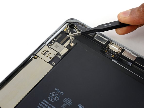

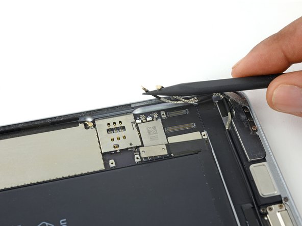

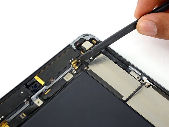

    • Use the flat end of a spudger to lift the rear-facing camera cable connector from its socket on the logic board.
    • Lift the sensor cable connector from its socket.
    • Disconnect the right cellular antenna from the logic board.

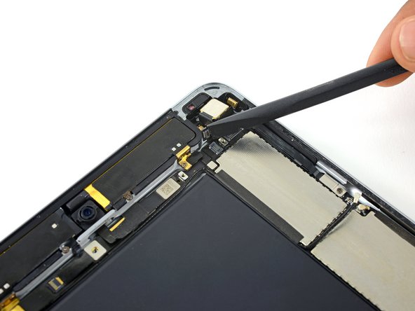

  37. iPad mini 4 LTE Logic Board Replacement: crwdns2935265:037crwdnd2935265:01crwdnd2935265:03crwdne2935265:0 iPad mini 4 LTE Logic Board Replacement: crwdns2935265:037crwdnd2935265:02crwdnd2935265:03crwdne2935265:0 iPad mini 4 LTE Logic Board Replacement: crwdns2935265:037crwdnd2935265:03crwdnd2935265:03crwdne2935265:0
    • Use the flat end of a spudger to disconnect the front-facing camera press connector.
    • Lift the Facetime camera ribbon cable out of the way and disconnect the headphone jack ribbon cable directly underneath it.

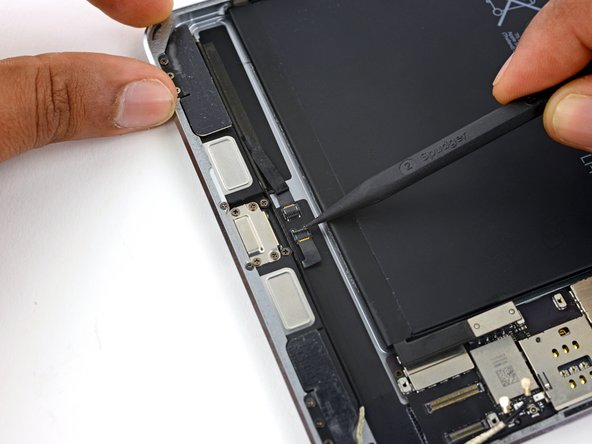

  38. iPad mini 4 LTE Logic Board Replacement: crwdns2935265:038crwdnd2935265:01crwdnd2935265:01crwdne2935265:0
    • Remove the 1.2 mm Phillips screw securing the volume control cable.
  39. iPad mini 4 LTE Logic Board Replacement: crwdns2935265:039crwdnd2935265:01crwdnd2935265:01crwdne2935265:0

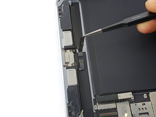

    • Remove the volume control cable bracket.
  40. iPad mini 4 LTE Logic Board Replacement: crwdns2935265:040crwdnd2935265:01crwdnd2935265:02crwdne2935265:0 iPad mini 4 LTE Logic Board Replacement: crwdns2935265:040crwdnd2935265:02crwdnd2935265:02crwdne2935265:0

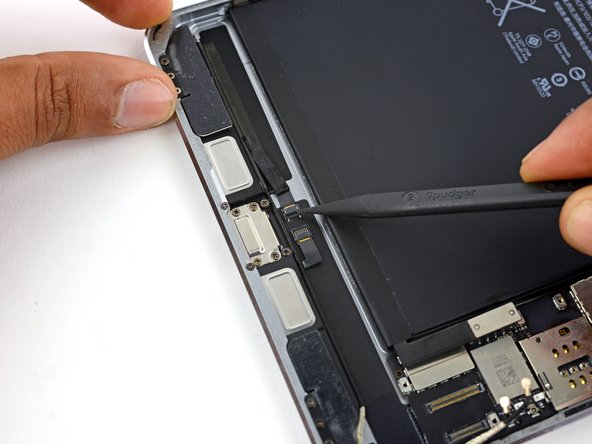

    • Use the point of a spudger to lift the volume control cable connector from its socket on the logic board.
    • Be careful to lift up only on the connector itself, not the socket on the logic board.

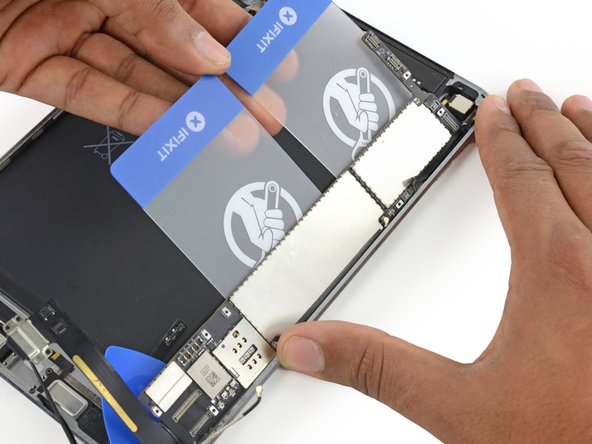

  41. iPad mini 4 LTE Logic Board Replacement: crwdns2935265:041crwdnd2935265:01crwdnd2935265:02crwdne2935265:0 iPad mini 4 LTE Logic Board Replacement: crwdns2935265:041crwdnd2935265:02crwdnd2935265:02crwdne2935265:0

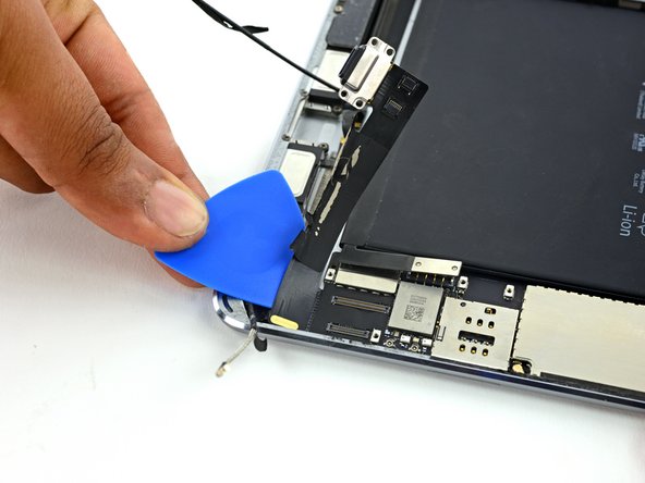

    • Use the point of a spudger to disconnect the two lower antenna interconnect cable connectors.
    • Lift the cables straight up from the board, do not pry on the sockets on the logic board.
    • The longer cable will reconnect to the socket nearest the SIM card slot. The shorter cable connects to the socket nearest the display cable connectors.

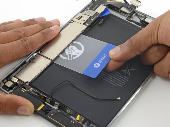

  42. iPad mini 4 LTE Logic Board Replacement: crwdns2935265:042crwdnd2935265:01crwdnd2935265:02crwdne2935265:0 iPad mini 4 LTE Logic Board Replacement: crwdns2935265:042crwdnd2935265:02crwdnd2935265:02crwdne2935265:0

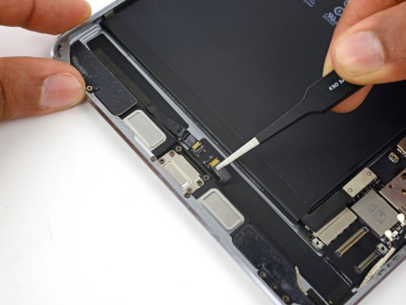

    • Remove any tape covering the ZIF connectors near the Lightning connector port.
  43. iPad mini 4 LTE Logic Board Replacement: crwdns2935265:043crwdnd2935265:01crwdnd2935265:03crwdne2935265:0 iPad mini 4 LTE Logic Board Replacement: crwdns2935265:043crwdnd2935265:02crwdnd2935265:03crwdne2935265:0 iPad mini 4 LTE Logic Board Replacement: crwdns2935265:043crwdnd2935265:03crwdnd2935265:03crwdne2935265:0
    • Use the tip of a spudger to lift each of the two ZIF connector retaining flaps.

    • Pull each speaker cable out from its ZIF socket.
  45. iPad mini 4 LTE Logic Board Replacement: crwdns2935265:045crwdnd2935265:01crwdnd2935265:02crwdne2935265:0 iPad mini 4 LTE Logic Board Replacement: crwdns2935265:045crwdnd2935265:02crwdnd2935265:02crwdne2935265:0
    • Peel the lower antenna interconnect cables away from the corner of the rear case.
  46. iPad mini 4 LTE Logic Board Replacement: crwdns2935265:046crwdnd2935265:01crwdnd2935265:02crwdne2935265:0 iPad mini 4 LTE Logic Board Replacement: crwdns2935265:046crwdnd2935265:02crwdnd2935265:02crwdne2935265:0
    • Peel the left antenna interconnect cable up off the Lightning port cable.
  47. iPad mini 4 LTE Logic Board Replacement: crwdns2935265:047crwdnd2935265:01crwdnd2935265:01crwdne2935265:0
    • Remove the four 1.5 mm Phillips screws securing the Lightning port to the rear case.
  48. iPad mini 4 LTE Logic Board Replacement: crwdns2935265:048crwdnd2935265:01crwdnd2935265:02crwdne2935265:0 iPad mini 4 LTE Logic Board Replacement: crwdns2935265:048crwdnd2935265:02crwdnd2935265:02crwdne2935265:0
    • Begin to gently lift the Lightning connector cable up.
  49. iPad mini 4 LTE Logic Board Replacement: crwdns2935265:049crwdnd2935265:01crwdnd2935265:03crwdne2935265:0 iPad mini 4 LTE Logic Board Replacement: crwdns2935265:049crwdnd2935265:02crwdnd2935265:03crwdne2935265:0 iPad mini 4 LTE Logic Board Replacement: crwdns2935265:049crwdnd2935265:03crwdnd2935265:03crwdne2935265:0
    • Use an opening pick to separate the adhesive connecting the lightning connector cable to the iPad case.
    • If you push with pick too hard, or slip, you could sever the Lightning port cable.
    • You should not need a lot of force, if you are struggling, reapply an iOpener to the back of the case to warm the adhesive.
  50. iPad mini 4 LTE Logic Board Replacement: crwdns2935265:050crwdnd2935265:01crwdnd2935265:02crwdne2935265:0 iPad mini 4 LTE Logic Board Replacement: crwdns2935265:050crwdnd2935265:02crwdnd2935265:02crwdne2935265:0
    • Continue to slide the pick under the Lightning port cable until you reach the end of the logic board.
    • Leave the pick in place to prevent the adhesive from re-adhering.

    • Bend back the battery connector over the battery, out of the way of the logic board.
    • Be very careful in the following steps not to sever any cables.

    • Once the adhesive has softened, carefully push the opening pick under the logic board.
    • Be very cautious and patient as you pry, do not sever the battery cable, antenna cable, or Lightning port cable.
  54. iPad mini 4 LTE Logic Board Replacement: crwdns2935265:054crwdnd2935265:01crwdnd2935265:02crwdne2935265:0 iPad mini 4 LTE Logic Board Replacement: crwdns2935265:054crwdnd2935265:02crwdnd2935265:02crwdne2935265:0
    Plastic Cards
    $2.99
    • Once the opening pick has lifted a corner of the logic board, you can insert a plastic card under the board.
    • Slide the plastic card under the logic board, toward the top of the iPad, near the cameras.
    • If the logic board adhesive provides too much resistance, reheat your iOpener and lay it on the rear case to soften the glue.
  55. iPad mini 4 LTE Logic Board Replacement: crwdns2935265:055crwdnd2935265:01crwdnd2935265:03crwdne2935265:0 iPad mini 4 LTE Logic Board Replacement: crwdns2935265:055crwdnd2935265:02crwdnd2935265:03crwdne2935265:0 iPad mini 4 LTE Logic Board Replacement: crwdns2935265:055crwdnd2935265:03crwdnd2935265:03crwdne2935265:0
    • Insert a second plastic card underneath the first one.
    • It's easiest to lead with the corner of the plastic card, then slide the long edge underneath the logic board.
    • Slide the second plastic card up to the top edge of the logic board.
  56. iPad mini 4 LTE Logic Board Replacement: crwdns2935265:056crwdnd2935265:01crwdnd2935265:02crwdne2935265:0 iPad mini 4 LTE Logic Board Replacement: crwdns2935265:056crwdnd2935265:02crwdnd2935265:02crwdne2935265:0
    • Lift up on the edges of both plastic cards to pry the logic board from the rear case.
  57. iPad mini 4 LTE Logic Board Replacement: crwdns2935265:057crwdnd2935265:01crwdnd2935265:01crwdne2935265:0
    • Remove the logic board assembly from the rear case.
    • If you are replacing your logic board with a new part, be sure the parts match identically, you may need to transfer additional components.
    • iPad mini 4 logic boards are paired to their home buttons, if you replace your logic board, you will no longer have Touch ID functionality.
