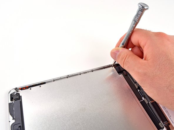

    • So far it looks like Apple has more tricks than treats for us with a hidden screw securing the display.
    • After dispatching two hidden screws and two exposed screws with our 54 Bit Driver Kit, we are able to lift the LCD.
    • Pulling up the display reveals a large metal plate, held in with no fewer than 16 screws.
    • We found similar plates in the iPod Touch 5th Generation, and the iPhone 5, so this seems to be a new iDevice design convention.

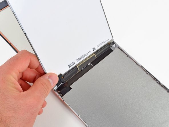

    • More tricks, fewer treats! With plastic opening tool in hand, we disconnect the display connector, but there's still something holding the LCD in…
  8. iPad Mini Wi-Fi Teardown: crwdns2935265:09crwdnd2935265:01crwdnd2935265:02crwdne2935265:0 iPad Mini Wi-Fi Teardown: crwdns2935265:09crwdnd2935265:02crwdnd2935265:02crwdne2935265:0
    • …and the culprit is found. Insulating tape holds the display to the rear case and protects the Lightning connector cable.
    • With the tape peeled up, we remove the display assembly and can turn our attention to the interior.
    • Bad news: due to the placement of connectors, you'll need to remove the LCD prior to removing the digitizer. Great news: the LCD and front glass are two separate components. This contrasts the fused glass-LCD assemblies in both the Kindle Fire HD and Nexus 7. Thanks for the repairability, Apple!

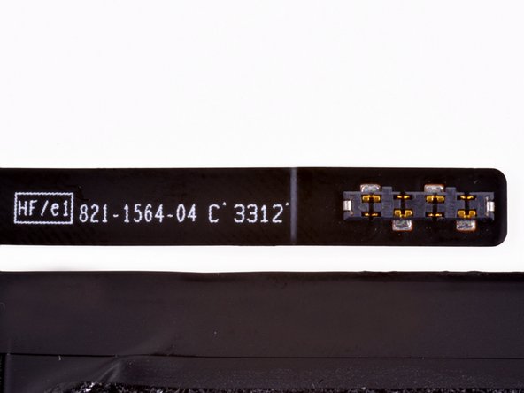

    • Fortunately, the iPad Mini inherited the connector-fastened battery from its larger sibling, not the soldered-in battery found in the iPod Touch.
    • A plastic card makes a nice tool to pry the battery up from the rear panel, but it's still a very difficult task to break through all of the adhesive securing it to the rear case without puncturing the cells.
    • A close-up of the battery connector exposes the numbers 821-1564-04 C 3312.

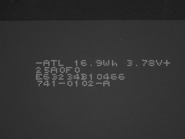

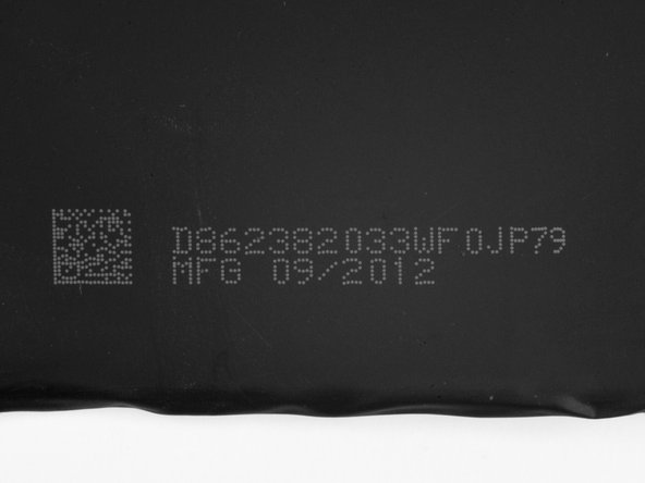

    • We get a good look at the battery, and find ourselves scratching our heads a bit.
    • This is a 3.72 V, 16.5 Whr, 4440 mAh battery.
    • Or maybe it's a 3.78 V, 16.9 Whr, 4400 mAh battery?
    • Or maybe it's a 3.72 V, 4400 mAh battery?
    • Or maybe, according to Apple's tech specs, it's only 16.3 Whr.
    • Whatever the capacity, it's decidedly mini when compared to the massive 43 Whr battery in the iPad 3. Even the venerable iPad 2 sports a 25 Whr package, 50% more than the iPad Mini.

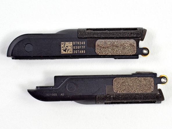

    • The folks at Amazon doubted, but we can confirm the Mini does indeed sport stereo speakers. In this one regard, the Mini outdoes the still-mono Retina iPad.
    • The reduction of connector size (30-pin to Lightning) has left just enough space to squeeze a second speaker into the device, allowing for sound quality that is anything but mini.

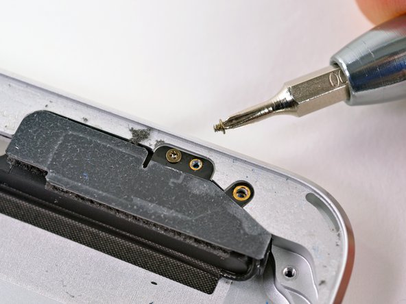

    • Two hidden screws secure the Lightning connector to the rear case.
    • They've been around less than two months, but Lightning ports are spreading like wildfire across nearly the entire iOS lineup. However, the iPad 2, iPhone 4/4S, and iPod Shuffle are still Lightning-less…for now.
    • As badly as we want to completely remove the Lightning port ribbon cable, we will have to wait, as it appears to be soldered to the logic board.

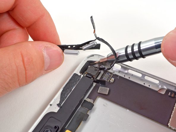

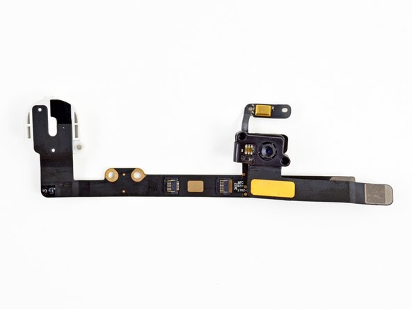

    • We're getting ready to examine the brains of this device, but not before clearing out the rest of the surrounding peripherals.
    • Several screws secure the power/volume buttons ribbon cable assembly to the rear case.

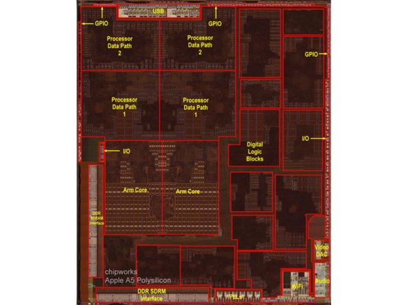

    • The A5 processor has 512 MB RAM, just like the processor in the latest iPod Touch.
    • How do we know? The package markings E4064P3PM-8D-5 indicate the A5 has two 2 Gb, LP DDR2 RAM dies inside, according to Chipworks.
    • These die photos from Chipworks shows the inner workings of the A5. Care to see the die in all its gory glory? Check out the high-res version.

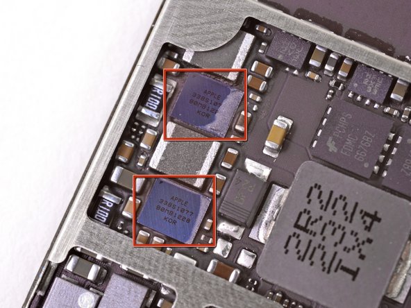

    • Apple 338S1077, aka Cirrus Logic Class D Amplifier (thanks Chipworks!)
