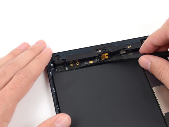

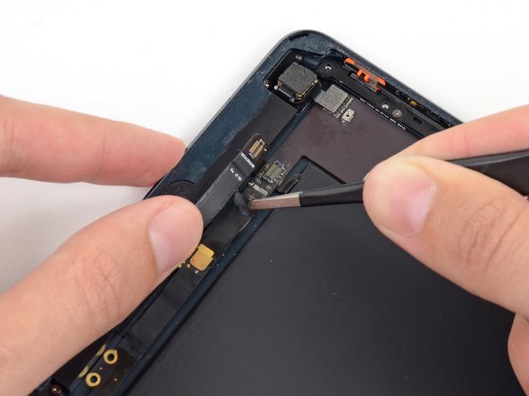

  32. iPad Mini Wi-Fi Headphone Jack Cable Replacement, LCD Assembly: crwdns2935265:032crwdnd2935265:01crwdnd2935265:03crwdne2935265:0 iPad Mini Wi-Fi Headphone Jack Cable Replacement, LCD Assembly: crwdns2935265:032crwdnd2935265:02crwdnd2935265:03crwdne2935265:0 iPad Mini Wi-Fi Headphone Jack Cable Replacement, LCD Assembly: crwdns2935265:032crwdnd2935265:03crwdnd2935265:03crwdne2935265:0
    • Small pieces of foam tape cover the top and bottom right-hand screws securing the LCD to the rear case.
    • Use tweezers to peel up and remove the rectangular piece of foam tape covering the top right LCD screw.
    • Remove the triangular tape covering the lower right LCD screw.
  33. iPad Mini Wi-Fi Headphone Jack Cable Replacement: crwdns2935265:033crwdnd2935265:01crwdnd2935265:02crwdne2935265:0 iPad Mini Wi-Fi Headphone Jack Cable Replacement: crwdns2935265:033crwdnd2935265:02crwdnd2935265:02crwdne2935265:0
    • The top left LCD screw may be covered by adhesive tape from the front panel.

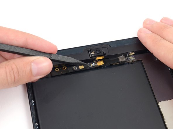

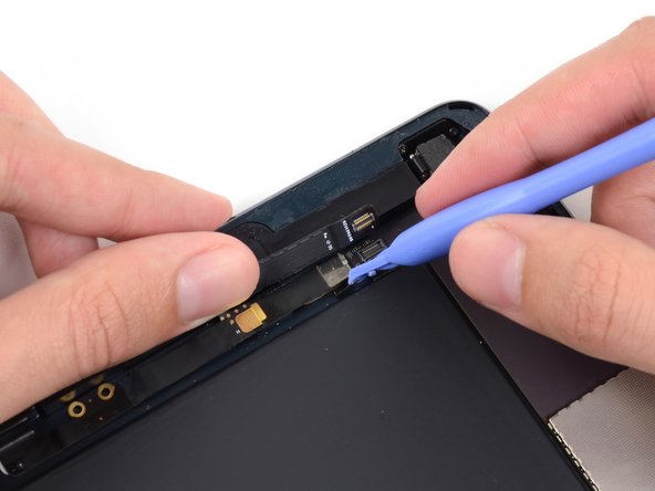

    • Use a plastic opening tool to pry the headphone jack cable's connector up from its socket on the logic board.
  71. iPad Mini Wi-Fi Headphone Jack Cable Replacement: crwdns2935265:071crwdnd2935265:01crwdnd2935265:03crwdne2935265:0 iPad Mini Wi-Fi Headphone Jack Cable Replacement: crwdns2935265:071crwdnd2935265:02crwdnd2935265:03crwdne2935265:0 iPad Mini Wi-Fi Headphone Jack Cable Replacement: crwdns2935265:071crwdnd2935265:03crwdnd2935265:03crwdne2935265:0

    • Use the tip of a spudger to gently lift the tab on the top left antenna ribbon cable's ZIF connector.
  73. iPad Mini Wi-Fi Headphone Jack Cable Replacement: crwdns2935265:073crwdnd2935265:01crwdnd2935265:03crwdne2935265:0 iPad Mini Wi-Fi Headphone Jack Cable Replacement: crwdns2935265:073crwdnd2935265:02crwdnd2935265:03crwdne2935265:0 iPad Mini Wi-Fi Headphone Jack Cable Replacement: crwdns2935265:073crwdnd2935265:03crwdnd2935265:03crwdne2935265:0

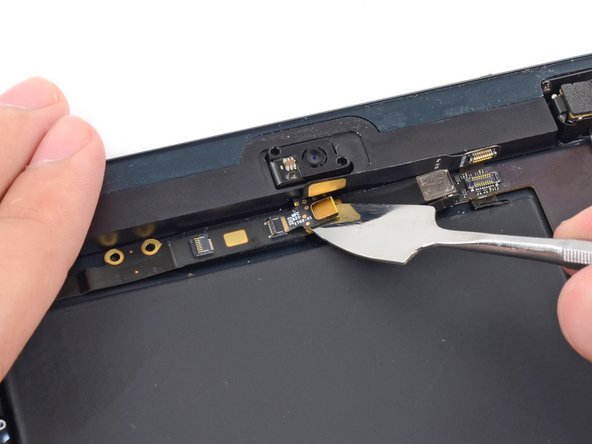

    • Slowly work the pointed end of a metal spudger underneath the microphone cable, separating the adhesive securing it to the headphone jack cable.
  74. iPad Mini Wi-Fi Headphone Jack Cable Replacement: crwdns2935265:074crwdnd2935265:01crwdnd2935265:02crwdne2935265:0 iPad Mini Wi-Fi Headphone Jack Cable Replacement: crwdns2935265:074crwdnd2935265:02crwdnd2935265:02crwdne2935265:0
    • Use tweezers to pull the microphone cable straight out from its ZIF socket.
  75. iPad Mini Wi-Fi Headphone Jack Cable Replacement: crwdns2935265:075crwdnd2935265:01crwdnd2935265:02crwdne2935265:0 iPad Mini Wi-Fi Headphone Jack Cable Replacement: crwdns2935265:075crwdnd2935265:02crwdnd2935265:02crwdne2935265:0
    • Gently bend the microphone cable up and out of the way of the headphone jack cable.

  77. iPad Mini Wi-Fi Headphone Jack Cable Replacement: crwdns2935265:077crwdnd2935265:01crwdnd2935265:03crwdne2935265:0 iPad Mini Wi-Fi Headphone Jack Cable Replacement: crwdns2935265:077crwdnd2935265:02crwdnd2935265:03crwdne2935265:0 iPad Mini Wi-Fi Headphone Jack Cable Replacement: crwdns2935265:077crwdnd2935265:03crwdnd2935265:03crwdne2935265:0

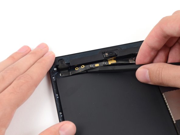

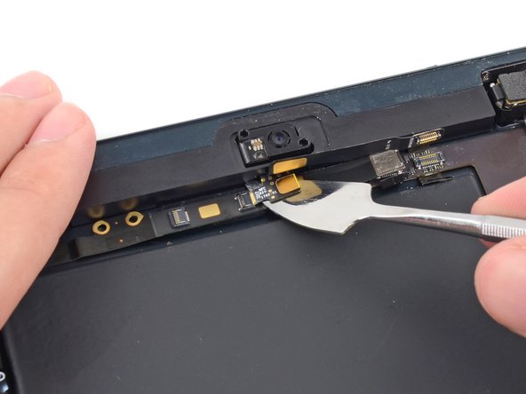

    • Slide the flat end of a spudger beneath the length of the headphone jack cable, separating the adhesive securing the cable to the rear case.
  78. iPad Mini Wi-Fi Headphone Jack Cable Replacement: crwdns2935265:078crwdnd2935265:01crwdnd2935265:02crwdne2935265:0 iPad Mini Wi-Fi Headphone Jack Cable Replacement: crwdns2935265:078crwdnd2935265:02crwdnd2935265:02crwdne2935265:0

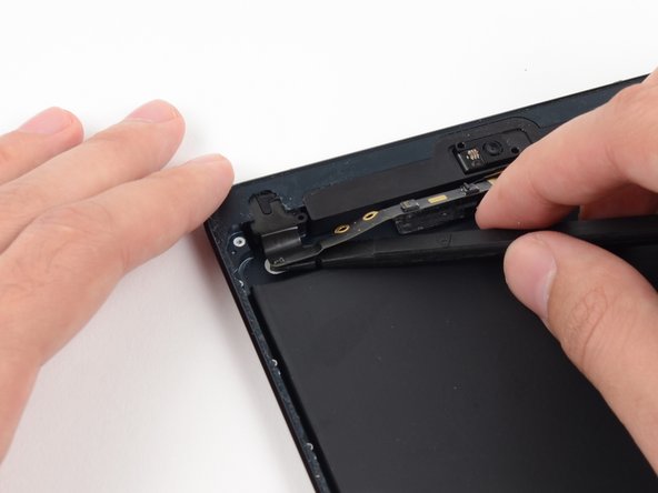

    • Continue to carefully pry under the cable near the headphone jack.
  79. iPad Mini Wi-Fi Headphone Jack Cable Replacement: crwdns2935265:079crwdnd2935265:01crwdnd2935265:02crwdne2935265:0 iPad Mini Wi-Fi Headphone Jack Cable Replacement: crwdns2935265:079crwdnd2935265:02crwdnd2935265:02crwdne2935265:0
    • Pull the headphone jack straight out of its recess in the rear case.
