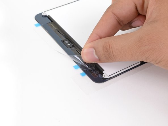

      • Before installing new adhesive, thoroughly clean the display assembly and the frame of all residue.
      • Use tweezers to pull up sections of tape residue.
      • Use an opening tool or a spudger to scrape residue off. You can use high concentration (over 90%) isopropyl alcohol to soften the adhesive.
      • Remove the residue by wiping in one direction to prevent smearing.
      • Do not scrape with a metal tool, or you will scratch the display assembly's surface.
    2. iPad Display Assembly 4 Pc. Adhesive Application: crwdns2935265:02crwdnd2935265:01crwdnd2935265:01crwdne2935265:0
      • Lay out the replacement adhesive strips around the display assembly so that they correspond to the correct sides.
    3. iPad Display Assembly 4 Pc. Adhesive Application: crwdns2935265:03crwdnd2935265:01crwdnd2935265:02crwdne2935265:0 iPad Display Assembly 4 Pc. Adhesive Application: crwdns2935265:03crwdnd2935265:02crwdnd2935265:02crwdne2935265:0

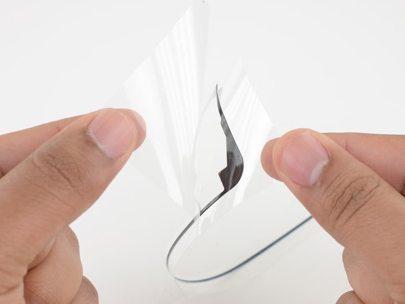

      • Each adhesive strip is encased in four layers of plastic—three on top and one on the bottom.

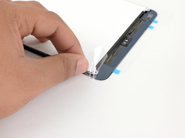

      • Peel and remove the topmost plastic cling layer from the left adhesive strip.
      • Peel and remove the bottom plastic liner from the strip.
      • The top of the adhesive strip should still be covered by a colored plastic layer as well as a clear plastic stiffening layer.
      • The bottom of the adhesive strip should now be exposed and sticky.
    4. iPad Display Assembly 4 Pc. Adhesive Application: crwdns2935265:04crwdnd2935265:01crwdnd2935265:02crwdne2935265:0 iPad Display Assembly 4 Pc. Adhesive Application: crwdns2935265:04crwdnd2935265:02crwdnd2935265:02crwdne2935265:0
      • If there are extra bits of adhesive on the strips that are not required for your particular model of iPad, remove them now.
    5. iPad Display Assembly 4 Pc. Adhesive Application: crwdns2935265:05crwdnd2935265:01crwdnd2935265:03crwdne2935265:0 iPad Display Assembly 4 Pc. Adhesive Application: crwdns2935265:05crwdnd2935265:02crwdnd2935265:03crwdne2935265:0 iPad Display Assembly 4 Pc. Adhesive Application: crwdns2935265:05crwdnd2935265:03crwdnd2935265:03crwdne2935265:0

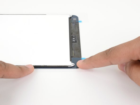

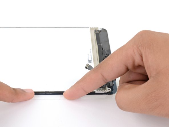

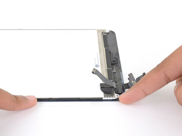

      • Align the left adhesive strip to the left edge of the display assembly.
      • Beginning from one corner, lay the adhesive strip onto the display assembly and press the strip into place.
      • If necessary, use a spudger to press down the narrow parts of the adhesive strip.
    6. iPad Display Assembly 4 Pc. Adhesive Application: crwdns2935265:06crwdnd2935265:01crwdnd2935265:03crwdne2935265:0 iPad Display Assembly 4 Pc. Adhesive Application: crwdns2935265:06crwdnd2935265:02crwdnd2935265:03crwdne2935265:0 iPad Display Assembly 4 Pc. Adhesive Application: crwdns2935265:06crwdnd2935265:03crwdnd2935265:03crwdne2935265:0

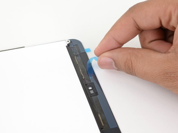

      • Repeat the process with the right adhesive strip.
      • Peel and remove the topmost cling layer from the strip.
      • Peel and remove the bottom liner layer from the strip.
      • Align the adhesive strip to the right edge of the display assembly.
      • Starting from one corner, lay the adhesive strip onto the display assembly and press in place.
    7. iPad Display Assembly 4 Pc. Adhesive Application: crwdns2935265:07crwdnd2935265:01crwdnd2935265:03crwdne2935265:0 iPad Display Assembly 4 Pc. Adhesive Application: crwdns2935265:07crwdnd2935265:02crwdnd2935265:03crwdne2935265:0 iPad Display Assembly 4 Pc. Adhesive Application: crwdns2935265:07crwdnd2935265:03crwdnd2935265:03crwdne2935265:0
      • Repeat the process for the top adhesive strip.
      • Peel and remove the bottom liner from the strip.
      • Align the strip to the top of the display assembly such that the straight adhesive line bridges the gap between the left and right strips.
      • Press the strip in place.
    8. iPad Display Assembly 4 Pc. Adhesive Application: crwdns2935265:08crwdnd2935265:01crwdnd2935265:03crwdne2935265:0 iPad Display Assembly 4 Pc. Adhesive Application: crwdns2935265:08crwdnd2935265:02crwdnd2935265:03crwdne2935265:0 iPad Display Assembly 4 Pc. Adhesive Application: crwdns2935265:08crwdnd2935265:03crwdnd2935265:03crwdne2935265:0
      • Repeat the process for the bottom adhesive strip.
      • Align the strip to the bottom of the display assembly such that the straight adhesive line bridges the gap between the left and right strips.
    9. iPad Display Assembly 4 Pc. Adhesive Application: crwdns2935265:09crwdnd2935265:01crwdnd2935265:03crwdne2935265:0 iPad Display Assembly 4 Pc. Adhesive Application: crwdns2935265:09crwdnd2935265:02crwdnd2935265:03crwdne2935265:0 iPad Display Assembly 4 Pc. Adhesive Application: crwdns2935265:09crwdnd2935265:03crwdnd2935265:03crwdne2935265:0
      • Peel and remove the clear plastic stiffening layer from all four adhesive strip sections.
    10. iPad Display Assembly 4 Pc. Adhesive Application: crwdns2935265:010crwdnd2935265:01crwdnd2935265:01crwdne2935265:0
      • Continue with the reassembly process until you are ready to seal the device.
    11. iPad Display Assembly 4 Pc. Adhesive Application: crwdns2935265:011crwdnd2935265:01crwdnd2935265:02crwdne2935265:0 iPad Display Assembly 4 Pc. Adhesive Application: crwdns2935265:011crwdnd2935265:02crwdnd2935265:02crwdne2935265:0
      • Peel and remove the four colored plastic liners to expose the adhesive.
      • Close the device and place something heavy, such as a stack of large books, on top for thirty minutes to help the new adhesive bond.
      • Alternatively, you can use screen vice clamps around the perimeter of your device to set the new adhesive.
