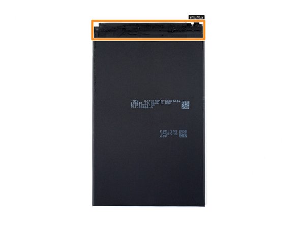

  15. iPad Mini 6 Battery Replacement, Battery removal information: crwdns2935265:015crwdnd2935265:01crwdnd2935265:02crwdne2935265:0 iPad Mini 6 Battery Replacement, Battery removal information: crwdns2935265:015crwdnd2935265:02crwdnd2935265:02crwdne2935265:0
    Plastic Cards
    $2.99
    • Before you begin the procedure, note the following:
    • There are four stretch release adhesive pull tabs that have to be removed to separate the adhesive underneath the battery.
    • The remainder of the adhesive is located on the top edge of the battery, near the connector; keep this in mind when inserting a plastic card.

  18. iPad Mini 6 Battery Replacement, Apply isopropyl alcohol: crwdns2935265:018crwdnd2935265:01crwdnd2935265:01crwdne2935265:0
    • Take care not to puncture or bend the battery with your tool—a punctured or bent battery may leak dangerous chemicals or cause a fire. In case you're struggling to pull up the battery, apply more isopropyl alcohol and try again.
    • Apply a few drops of high concentration (over 90%) isopropyl alcohol to the gaps surrounding the battery's top edge.
  19. iPad Mini 6 Battery Replacement: crwdns2935265:019crwdnd2935265:01crwdnd2935265:02crwdne2935265:0 iPad Mini 6 Battery Replacement: crwdns2935265:019crwdnd2935265:02crwdnd2935265:02crwdne2935265:0
    • Tilt the top edge of the device upward to allow the isopropyl alcohol to work its way underneath the battery.
    • Hold for 1–2 minutes to allow time for the isopropyl alcohol to weaken the adhesive.
