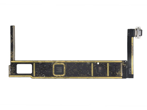

    • Let's see what kind of silicon Apple managed to squeeze in here:
    • Apple APL1W81 A12 Bionic SoC, layered over Samsung K3UH4H40AM-MGCL 3 GB LPDDR4X DRAM
    • Toshiba TSB3243VD1190CHNA1 64 GB flash memory
    • Apple/USI 339S00551 Bluetooth/WiFi module
    • Broadcom BCM15900 touchscreen controller
    • Apple 343S00286-A0 and 343S00282-A0 power management ICs (left to right)
    • NXP Semiconductor CBTL1612A1 display port multiplexer
    • NXP Semiconductor 100VB27 (SN100V) NFC controller
  9. iPad Mini 5 Teardown: crwdns2935265:09crwdnd2935265:01crwdnd2935265:03crwdne2935265:0 iPad Mini 5 Teardown: crwdns2935265:09crwdnd2935265:02crwdnd2935265:03crwdne2935265:0 iPad Mini 5 Teardown: crwdns2935265:09crwdnd2935265:03crwdnd2935265:03crwdne2935265:0
    • IC identification, continued:
    • Cirrus Logic CS42L83A audio codec
    • Cirrus Logic audio amplifier
    • Cypress Semiconductor CYPD2104 USB-C port controller
    • Bosch Sensortec accelerometer/gyroscope
    • Bosch Sensortec pressure sensor
    • AKM Semiconductor AK0991xx digital compass
