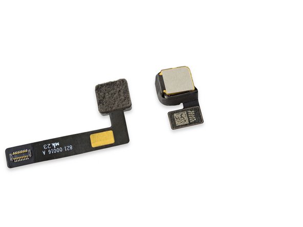

  8. iPad Mini 4 Teardown: crwdns2935265:08crwdnd2935265:01crwdnd2935265:03crwdne2935265:0 iPad Mini 4 Teardown: crwdns2935265:08crwdnd2935265:02crwdnd2935265:03crwdne2935265:0 iPad Mini 4 Teardown: crwdns2935265:08crwdnd2935265:03crwdnd2935265:03crwdne2935265:0
    • Beauty is in the eye of the beholder, and these beholders have some pretty nice specs.
    • No longer the red-headed stepchild of the iPad line, the Mini 4 inherits the 8 MP iSight camera from the iPad Air, while retaining the familial 1.2 MP FaceTime camera.
    • Gone also is the front-facing camera's plastic housing. Looks like Apple engineers are steadfastly streamlining the design in the Air's direction.
