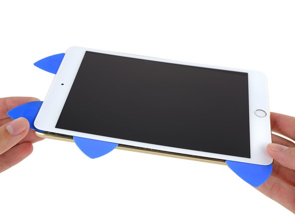

    • The iOpener has revolutionized the way we open up iPads.
    • A little heat is just the thing to soften up the adhesive securing the iPad's display.
    • We place our iOpener around the perimeter of the iPad Mini 3 and begin using our opening picks to separate the front panel from the rear case.
    • After a bit of work and patience, we achieve our goal.

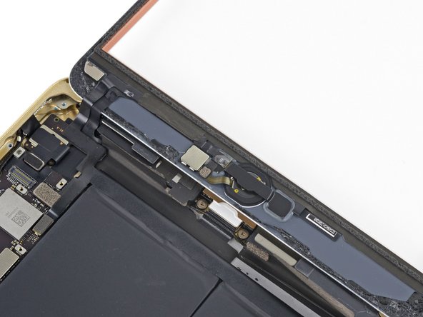

    • As is often the case with updates that don't really change anything, nothing has really changed yet.
    • Unlike in the new iPad Air 2, the front panel glass and LCD are still separate components, individually replaceable.
    • Take a look, it's in a book...

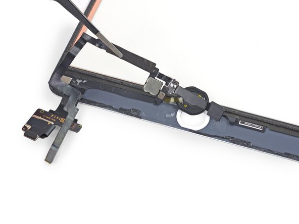

    • With the LCD out, we find our first and only change in construction: Some absolutely terrific home button cabling. Wow. That wasn't last-minute at all.
    • Is that hot glue?
  5. iPad Mini 3 Wi-Fi Teardown: crwdns2935265:05crwdnd2935265:01crwdnd2935265:03crwdne2935265:0 iPad Mini 3 Wi-Fi Teardown: crwdns2935265:05crwdnd2935265:02crwdnd2935265:03crwdne2935265:0 iPad Mini 3 Wi-Fi Teardown: crwdns2935265:05crwdnd2935265:03crwdnd2935265:03crwdne2935265:0

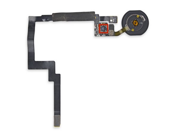

    • Yes—that is hot glue, holding the home button bracket to the front panel. Good luck transferring that to your replacement glass. (Which you're going to have to do, to keep the Touch ID functionality after a cracked screen repair.)
    • Looks like the cable is a bit of a nightmare all by itself.
    • Apple's system for implementing Touch ID seems to require launching about a year before it's ready. Remember the Touch ID cable in the iPhone 5s? And the much-improved placement in the iPhone 6?
    • No surprises here: Touch ID in the Mini is powered by an NXP Semiconductors 8416A1 Touch ID Sensor.
