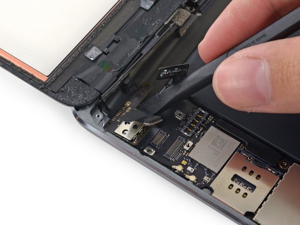

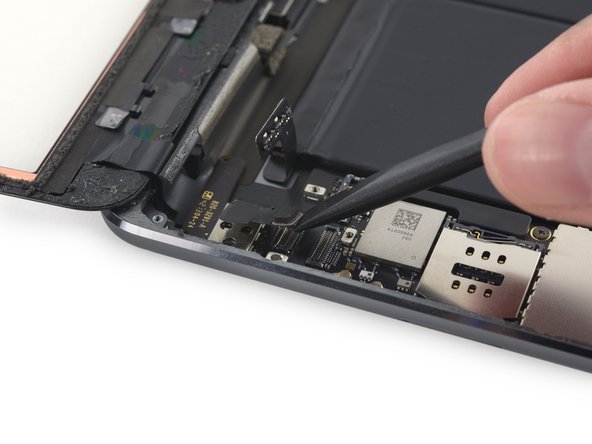

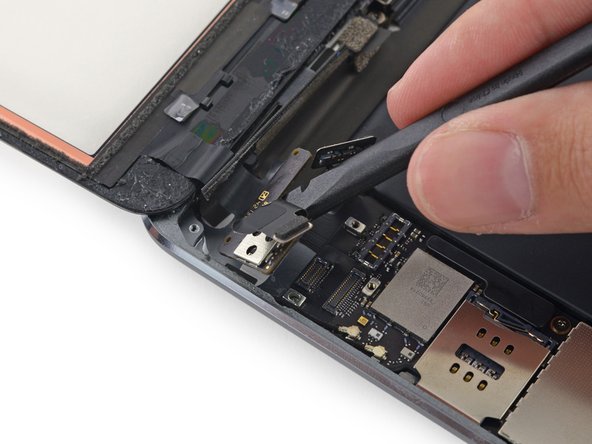

    27. iPad Mini 2 LTE Front Panel Replacement: crwdns2935265:031crwdnd2935265:01crwdnd2935265:03crwdne2935265:0 iPad Mini 2 LTE Front Panel Replacement: crwdns2935265:031crwdnd2935265:02crwdnd2935265:03crwdne2935265:0 iPad Mini 2 LTE Front Panel Replacement: crwdns2935265:031crwdnd2935265:03crwdnd2935265:03crwdne2935265:0
      • The front-facing camera housing may stick to the front panel; peel up the housing and place it back over the camera to protect it.
      • Rock the camera housing up on one edge to free it from the adhesive and remove it from the front panel.
      • Return the front-facing camera housing to its recess in the rear case.
    28. iPad Mini 2 LTE Front Panel Replacement: crwdns2935265:032crwdnd2935265:01crwdnd2935265:02crwdne2935265:0 iPad Mini 2 LTE Front Panel Replacement: crwdns2935265:032crwdnd2935265:02crwdnd2935265:02crwdne2935265:0
      • Remove the following Phillips #00 screws securing the LCD:
      • Three 3.3 mm screws
      • One 4.5 mm screw
      • If there is tape covering any LCD screws, peel it up with tweezers.
    29. iPad Mini 2 LTE Front Panel Replacement: crwdns2935265:033crwdnd2935265:01crwdnd2935265:02crwdne2935265:0 iPad Mini 2 LTE Front Panel Replacement: crwdns2935265:033crwdnd2935265:02crwdnd2935265:02crwdne2935265:0
      • Do not attempt to fully remove the LCD. It is still connected to the iPad by several cables at the home button end. Lift only from the front-facing camera end.

    1. iPad Mini 2 LTE Front Panel Replacement, Digitizer: crwdns2935265:045crwdnd2935265:01crwdnd2935265:02crwdne2935265:0 iPad Mini 2 LTE Front Panel Replacement, Digitizer: crwdns2935265:045crwdnd2935265:02crwdnd2935265:02crwdne2935265:0
      • Use the flat end of a spudger to lift the digitizer cable connector straight up off of its socket.
    2. iPad Mini 2 LTE Front Panel Replacement: crwdns2935265:046crwdnd2935265:01crwdnd2935265:03crwdne2935265:0 iPad Mini 2 LTE Front Panel Replacement: crwdns2935265:046crwdnd2935265:02crwdnd2935265:03crwdne2935265:0 iPad Mini 2 LTE Front Panel Replacement: crwdns2935265:046crwdnd2935265:03crwdnd2935265:03crwdne2935265:0
      • Slide the spudger under the battery side of the digitizer board to begin separating it from the rear case.
      • Lift the digitizer board up to free the last of the adhesive.
    3. iPad Mini 2 LTE Front Panel Replacement: crwdns2935265:047crwdnd2935265:01crwdnd2935265:01crwdne2935265:0
      • Lift and remove the front panel from the iPad.
