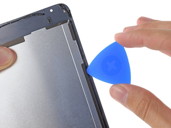

  5. iPad Air 2 Teardown: crwdns2935265:05crwdnd2935265:01crwdnd2935265:02crwdne2935265:0 iPad Air 2 Teardown: crwdns2935265:05crwdnd2935265:02crwdnd2935265:02crwdne2935265:0
    • Coming up next: classic iPad reruns—careful prying and tons of heat.
    • The newly-bonded front panel is more rigid than in previous iPad models, and therefore feels a bit sturdier to pry against—however, flexing the glass still disturbs the LCD, even when you aren't inserting the pick very deeply.
    • That being the case, the glued-down display remains the iPad's only access point, so there's still a risk of damaging it even when performing ordinary repairs.

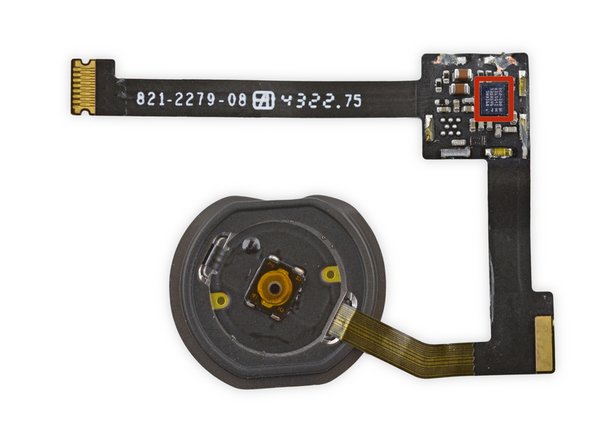

    • The design of the Air 2's Touch ID sensor cable closely resembles that of the new generation of iPhones.
    • With the home button removed, we discover a single IC on the home button assembly:
    • NXP Semiconductors 8416A1 Touch ID Sensor

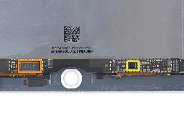

    • Further inspection reveals even more ICs on the front panel assembly:
    • Parade Technologies DP675 LCD Driver
    • Texas Instruments TPS65143A LCD Bias Solution For LCD Panels

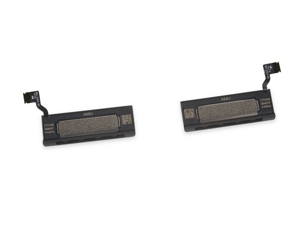

    • Next we set our spudgers to the fancy, and tiny, new speaker units.
    • Unfortunately, they are not speaking to us, and their markings don't have many secrets to divulge...
    • Not waiting around for the awkward silence, we press on to glory.

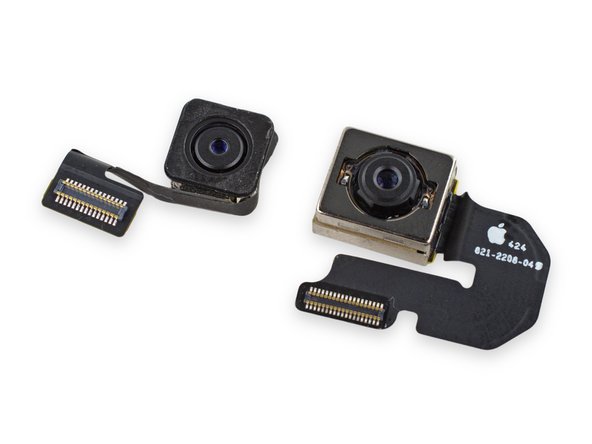

    • Our next step is to remove the FaceTime HD camera and microphone-encircled 8 MP iSight camera.
    • When compared to the larger, bump-inducing iSight camera from the iPhone 6 Plus, we can see they aren't quite the same—but it's indeed a leap in quality over the iSight camera found in the first-gen iPad Air.

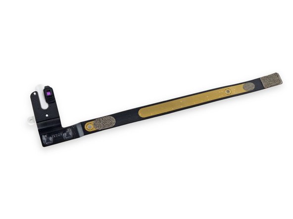

  10. iPad Air 2 Teardown: crwdns2935265:010crwdnd2935265:01crwdnd2935265:02crwdne2935265:0 iPad Air 2 Teardown: crwdns2935265:010crwdnd2935265:02crwdnd2935265:02crwdne2935265:0
    • The location and design of the headphone jack remains mostly identical. We say mostly due to one small change...
    • It seems the FaceTime HD camera ambient light sensor has been split into two sensors—one now residing on the headphone jack.

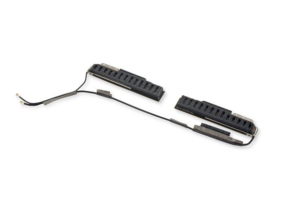

    • Our Wi-Fi model's antennas now grace the top of the iPad, where previously they were ensconced along the lower edge.
    • We're curious to see where the Air 2 LTE models will hide their cellular antennas.
    • With the swoop of a spudger, the antennas are roused from their foamy beds.

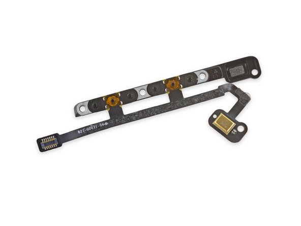

    • In a bevy of twos, we pull the first of two microphones, the second ambient light sensor, and the (single) power switch from the iPad Air 2.
    • A second round of twos brings us the other microphone, and two volume switches on a single cable.

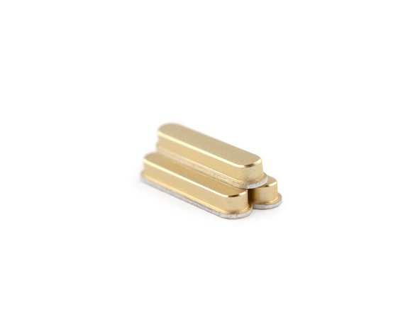

    • The following markings were found on the microphones:
    • M1300 5743 M1 334 (found on the power button cable assembly)
    • M1300 5723 M1 334 (found on the volume buttons cable)
    • On a side note, the power and volume buttons stack nicely.
