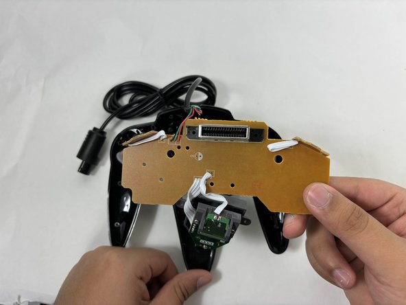

  4. iNNEXT N64 Classic Controller Face Buttons Replacement, Face Buttons: crwdns2935265:04crwdnd2935265:01crwdnd2935265:02crwdne2935265:0 iNNEXT N64 Classic Controller Face Buttons Replacement, Face Buttons: crwdns2935265:04crwdnd2935265:02crwdnd2935265:02crwdne2935265:0
    • Use a Phillips screwdriver to remove the 6 screws securing the joystick assembly to the top of the controller.
    • Gently lift the control panel and joystick assembly from the top cover of the controller.
  5. iNNEXT N64 Classic Controller Face Buttons Replacement: crwdns2935265:05crwdnd2935265:01crwdnd2935265:01crwdne2935265:0
    • Remove the silicone button gaskets.
  6. iNNEXT N64 Classic Controller Face Buttons Replacement: crwdns2935265:06crwdnd2935265:01crwdnd2935265:01crwdne2935265:0
    • Remove the old buttons by either pulling them out or pushing lightly from the front of the top case.
