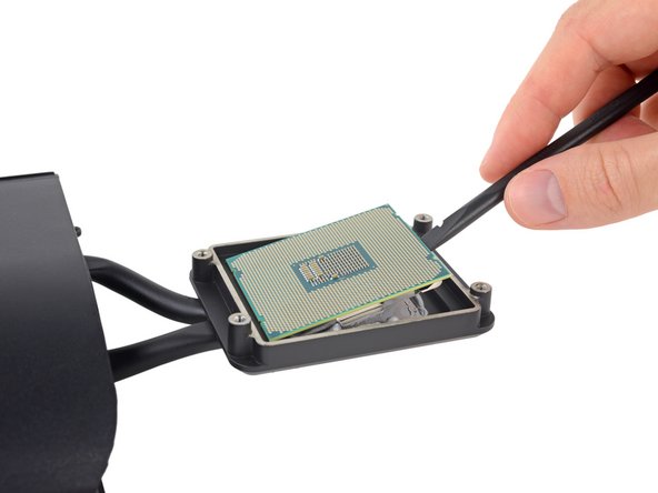

    • Do you want to know what's hiding under this enormous heat sink? So do we. After twirling away a few more Torx screws and tossing aside the mounting springs, we have an answer:
    • One GPU, which sadly is BGA-soldered in place. And at the opposite side, one workstation-class Xeon processor—not soldered in place.
    • It's too early to say how feasible a CPU upgrade might be—the chip appears to be custom-made for Apple by Intel. But upgrades seem at least theoretically possible.
    • It might be nice if your $5,000+ workstation could get an upgrade once in a while, rather than a full replacement... right?

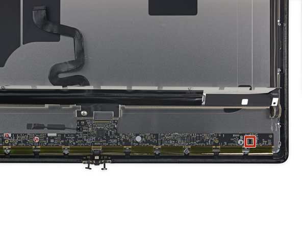

    • Time to take a closer look at that display. Turns out it uses the same display panel we found in the iMac 5K: LG Display model LM270QQ1.
    • That said, the cabling arrangement and webcam hardware have been moved around—so you can't swap displays between models.

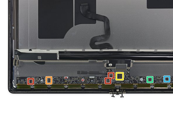

    • We peel up the long strip of shielding along the bottom to reveal the chips:
    • Texas Instruments NH245 8-Bit Dual-Supply Bus Transceiver
    • Texas Instruments BUF16821 Programmable Gamma-Voltage Generator and Vcom Calibrator
    • Parade Technologies DP665 LCD Timing Controller
    • Texas Instruments TPS54320 3A synchronous step-down SWIFT™ converter
    • Texas Instruments TPS65168 High Resolution Fully Programmable LCD Bias IC for TV
