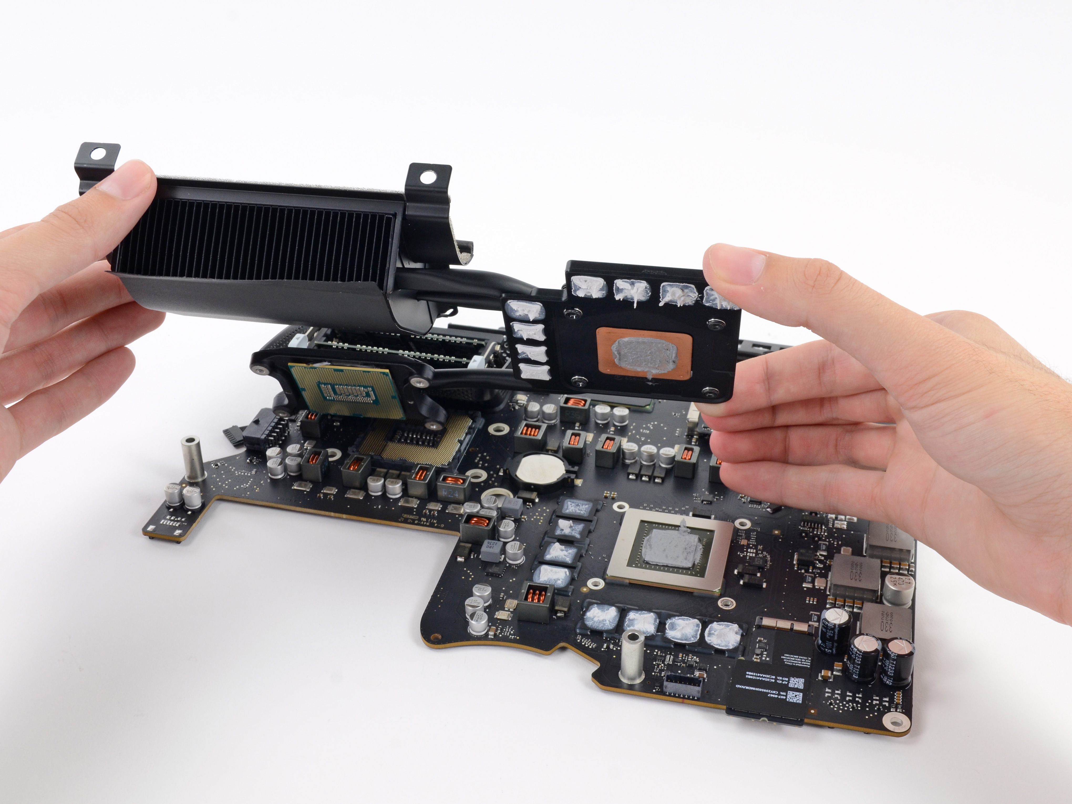

  10. iMac Intel 27" Retina 5K Display CPU Replacement: crwdns2935265:010crwdnd2935265:01crwdnd2935265:03crwdne2935265:0 iMac Intel 27" Retina 5K Display CPU Replacement: crwdns2935265:010crwdnd2935265:02crwdnd2935265:03crwdne2935265:0 iMac Intel 27" Retina 5K Display CPU Replacement: crwdns2935265:010crwdnd2935265:03crwdnd2935265:03crwdne2935265:0
    Plastic Cards
    $2.99
    • While the opening tool did the lion's share of the work, the display will still be slightly adhered to the case. A plastic card will be necessary to free up the last of this adhesive.
    • Set the iMac face-up on a table.
    • Starting from the top right corner of the iMac, insert a plastic card between the display and frame.
    • Be careful not to insert it more than 3/8" (9.5 mm), or you may damage internal components.
    I actually DESTROYED my display (black vertical strips) by pushing the card in a bit TOO DEEP. So it is REALLY important to insert the card only a bit (1-2mm) more than the cutter wheel, in particular at the top side, where many flat cables connect the panel with the PCB. These can be damaged very easily!
    Peter Fischer - crwdns2934203:0crwdne2934203:0
    Same thing with me…. Pushed cards to far…. new panel needed…€600…..
    i think ifixit needs to place a bigger caveat, as I have missed it the first time
    Edgar Broekema - crwdns2934203:0crwdne2934203:0
    i successfully upgraded two imacs. one opened with ifixit pizza knife and another with a regular paper knife. however, when i had to open the first one once again i broke its screen glass. it seems ifixit adhesive strips are too strong. next time i’ll try to use heater to weaken glue tension.
    Eugene Kharkov - crwdns2934203:0crwdne2934203:0
    I broke one too. And even if you think you did it correctly, you’ll not be able to see where you might have gone too far. You would think it’s very protected behind that metal plate, but no. Take special care with this offence to “right to repair” This should have been designed WAY better. I mean replacing a hardrive that is very likely to fail over the course of time, or even a simple desire to upgrade to an ssd!.
    Bummer
    Denis Sytmen - crwdns2934203:0crwdne2934203:0
    HINT: If you turn the card and use the blue part of it, then you can avoid going to deep: no further then the blue part …
    Barthold - crwdns2934203:0crwdne2934203:0
    On the cards I got with my iFixit kit, the blue part was way bigger than 9.5mm — closer to 20mm!
    I made a line 9mm from the edge of each of my cards and used that as a guide.

  63. iMac Intel 27" Retina 5K Display CPU Replacement: crwdns2935265:063crwdnd2935265:01crwdnd2935265:03crwdne2935265:0 iMac Intel 27" Retina 5K Display CPU Replacement: crwdns2935265:063crwdnd2935265:02crwdnd2935265:03crwdne2935265:0 iMac Intel 27" Retina 5K Display CPU Replacement: crwdns2935265:063crwdnd2935265:03crwdnd2935265:03crwdne2935265:0
    • Lift the heat sink up from the logic board.
    • The CPU will most likely stick to the heat sink, so be careful about where you put it down.
    C'est l'étape la plus importante : au moment de retirer le dissipateur, il faut faire très attention de ne surtout pas tordre ou endommager les pins du socket processeur ! Car la cage pour la RAM gêne le mouvement pour enlever le dissipateur et le CPU est probablement toujours collé au dissipateur avec la pâte thermique.
    Si les pins du socket CPU sont endommagés le Mac ne redémarrera pas et sera hors service.
    Je préconise d'ajouter une étape avant la 59 : démonter la cage pour la RAM, il y a 3 toutes petites vis et un peu d'adhésif. Cela permet d'être plus à l'aise avec le retrait du dissipateur.
    zhorglub - crwdns2934203:0crwdne2934203:0
  64. iMac Intel 27" Retina 5K Display CPU Replacement, Remove the CPU: crwdns2935265:064crwdnd2935265:01crwdnd2935265:03crwdne2935265:0 iMac Intel 27" Retina 5K Display CPU Replacement, Remove the CPU: crwdns2935265:064crwdnd2935265:02crwdnd2935265:03crwdne2935265:0 iMac Intel 27" Retina 5K Display CPU Replacement, Remove the CPU: crwdns2935265:064crwdnd2935265:03crwdnd2935265:03crwdne2935265:0
    • The CPU will most likely be stuck to the heat sink with thermal compound.
    • Insert the flat end of a spudger between the CPU and heat sink.
    • Gently pry the CPU up by slightly twisting the spudger.
    • Remove the CPU from the heat sink. Be careful not to touch the contacts.
    • Disassembly is now complete—the following steps are for reinstalling the CPU.
    Putting the heat sync back on your new CPU is really difficult. I over tightened and borked my new CPU. Also, it's quite possible that you're going to put a great deal of stress on your Logic Board if you are putting an i7 processor in an i5 board. There is extra cooling installed on the i7 boards with bigger graphics cards. I wound up getting new logic board designed for i7 and having a repair shop do the upgrade (Which is a difficult feat in itself as it's difficult to procure Apple parts on your own). I still came out ahead over buying new or buying a used model with the full specs. But only barely. I'd highly recommend working with a friend or someone that has taken an iMac apart before. Look very carefully at how much tension and is applied on the current CPU before disassembly of the heat sync and adding a new one. Once you've done it once it's not to complicated.
    Chris Bernard - crwdns2934203:0crwdne2934203:0
    I second that note about installing a new CPU. It is VERY hard to put it back undamaged and I too got mine bent.
    The way I managed to do it was working sort of upside down: left the board on the desk then sat on the floor to screw the GPU bracket in place first then one side of the CPU bracket one-handed whilst using the other and to make sure the heatsink wouldn’t move and F my CPU again. Only then I flipped the board to attach the other screws which was extra hard as that spring is very strong.
    Didnt know about that issue replacing a i5 with a i7 though… saw several guides online where people did exactly that with no problems at all…
    Carlos Ferrari - crwdns2934203:0crwdne2934203:0

    • Before installing the heat sink, see our thermal paste guide for instructions on cleaning and preparing the thermal surfaces and applying a new layer of thermal compound onto the CPU and GPU dies.
    • For the VRAM chips surrounding the GPU, install thermal pads or a thick thermal paste such as thermal putty or K5-PRO, rather than regular thermal paste.
    • The above-mentioned "thermal surfaces" are as follows:
    • The CPU
    • The GPU
    • The VRAM chips
    • The heat sink plates
    • Note that the heat sink does not need new thermal paste. Clean it, but only apply thermal paste to the other surfaces.
    WARNING! When applying thermal paste on the GPU, spread it with a gloved finger! Apply a little more thermal paste on top of it and then make you push the heat sink down firmly onto the GPU die!

  68. iMac Intel 27" Retina 5K Display CPU Replacement, Install the heat sink: crwdns2935265:068crwdnd2935265:01crwdnd2935265:02crwdne2935265:0 iMac Intel 27" Retina 5K Display CPU Replacement, Install the heat sink: crwdns2935265:068crwdnd2935265:02crwdnd2935265:02crwdne2935265:0
    • Align the holes on the CPU section of the heat sink with the pins on the backing plate.
    • Set the heat sink straight down on the CPU, GPU, and VRAM chips.
    • Do not move the heat sink around once it contacts the CPU. The thermal paste will adhere the CPU to the heat sink and moving it around can bend the CPU pins.

    I highly recommend removing the RAM cage, it is really challenging to align the heat sink over the CPU with the the cage in the way. The thermal paste wants to stick while aligning to the pins. It was much easier to remove the cage and drop the heat sink into alignment without the cage in the way.
    Chr Paris - crwdns2934203:0crwdne2934203:0
    Yes, I agree, removing the cage makes it easier. After reinstalling the heatsink, I was able to reinstall the cage by cutting one side of it, which allowed the cage to be spread wider so that it could be reused. Once in place the screws held it into position. This upgrade was on my 2013 iMac which I upgraded from the base i5 to the i7 (4771) One thing I noticed is that the fan runs more because of the higher temperatures generated by the i7…I would say the gains were modest, but whether it is worth it….I am not sure.
    S. Baxter - crwdns2934203:0crwdne2934203:0
    You don’t need to cut the cage , just bend it out slightly and move the RAM arms open to allow it to slot back into place.
    markduff - crwdns2934203:0crwdne2934203:0
    Watch when removing the cage, the DIMM proximity sensor NPN's (4 total part no. BC846BLP4-7B) are under the edge of the cage and may dislodge causing issues. Resoldering back with microscope, heat gun, etc. is not easy!

Hi, used k5-Pro thermal paste covering at least 60% of the surface of both GPU memory and GPU dye but it’s overheating and on a GPU stress test it reaches 105 Celcius and the iMac shut’s down. Any advice?
Ovidiu Visan - crwdns2934203:0crwdne2934203:0
This image shows the factory thermal paste application right after the heat sink was removed. That’s the approximate amount you need (although hopefully much tidier, haha). Beyond that, just make sure the heat sink is installed correctly and check to make sure there’s good contact between the chips -> thermal compound -> heat sink. If the thermal compound doesn’t fully bridge that gap, the heat won’t go anywhere and before long the system will shut down to protect itself.
Jeff Suovanen -
