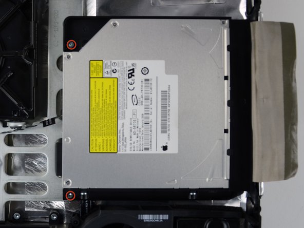

  12. iMac Intel 24" EMC 2267 Optical Drive Replacement, Optical Drive: crwdns2935265:012crwdnd2935265:01crwdnd2935265:02crwdne2935265:0 iMac Intel 24" EMC 2267 Optical Drive Replacement, Optical Drive: crwdns2935265:012crwdnd2935265:02crwdnd2935265:02crwdne2935265:0
    • Peel off the tape holding the optical drive in place.
    • Remove the two 7.1 mm T10 torx screws.
  13. iMac Intel 24" EMC 2267 Optical Drive Replacement: crwdns2935265:013crwdnd2935265:01crwdnd2935265:03crwdne2935265:0 iMac Intel 24" EMC 2267 Optical Drive Replacement: crwdns2935265:013crwdnd2935265:02crwdnd2935265:03crwdne2935265:0 iMac Intel 24" EMC 2267 Optical Drive Replacement: crwdns2935265:013crwdnd2935265:03crwdnd2935265:03crwdne2935265:0
    • Firmly grab the optical drive connector and pull it straight out of the optical drive.
    • Remove the optical drive from the device.

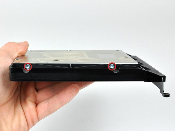

  19. iMac Intel 24" EMC 2267 Optical Drive Replacement: crwdns2935265:019crwdnd2935265:01crwdnd2935265:02crwdne2935265:0 iMac Intel 24" EMC 2267 Optical Drive Replacement: crwdns2935265:019crwdnd2935265:02crwdnd2935265:02crwdne2935265:0
    • Remove the two T10 Torx screws from both sides of the optical drive (four screws total).

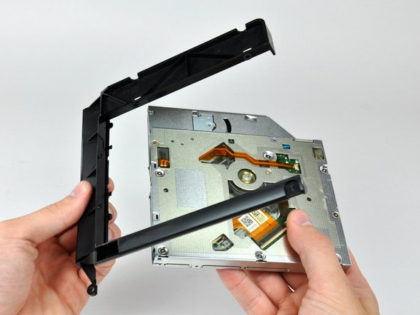

  20. iMac Intel 24" EMC 2267 Optical Drive Replacement: crwdns2935265:020crwdnd2935265:01crwdnd2935265:01crwdne2935265:0
    • Use the tip of a spudger to press each of the optical drive bracket tabs out of their slots on the bottom of the optical drive.
  21. iMac Intel 24" EMC 2267 Optical Drive Replacement: crwdns2935265:021crwdnd2935265:01crwdnd2935265:02crwdne2935265:0 iMac Intel 24" EMC 2267 Optical Drive Replacement: crwdns2935265:021crwdnd2935265:02crwdnd2935265:02crwdne2935265:0
    • Rotate the optical drive bracket slightly away from the optical drive.
    • Pull the optical drive bracket away from the open end of the optical drive, minding any tabs that may get caught.
    • If you have a disk or anything else stuck inside your optical drive, we have a guide to fix it.
