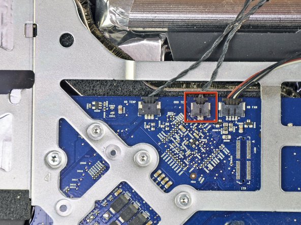

  13. iMac Intel 24" EMC 2134 and 2211 Optical Drive Replacement, Optical Drive: crwdns2935265:013crwdnd2935265:01crwdnd2935265:01crwdne2935265:0
    • If necessary, remove the pieces of tape securing the hard drive/optical drive thermal sensor cables to your iMac.
    • Disconnect the optical drive thermal sensor connector from the logic board by pulling its connector toward the top of your iMac.

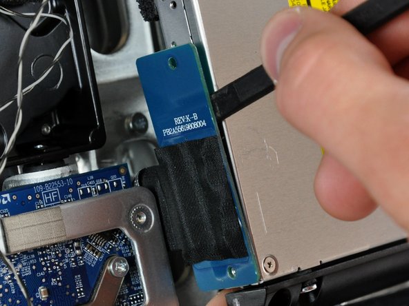

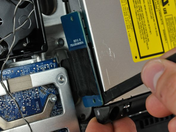

  16. iMac Intel 24" EMC 2134 and 2211 Optical Drive Replacement: crwdns2935265:016crwdnd2935265:01crwdnd2935265:02crwdne2935265:0 iMac Intel 24" EMC 2134 and 2211 Optical Drive Replacement: crwdns2935265:016crwdnd2935265:02crwdnd2935265:02crwdne2935265:0
    • Insert the flat end of a spudger between the optical drive connector and the body of the optical drive.
    • Twist the spudger to separate the connector from the optical drive.
    • It may be necessary to work from alternating sides of the connector until it is disconnected.

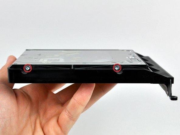

  21. iMac Intel 24" EMC 2134 and 2211 Optical Drive Replacement: crwdns2935265:021crwdnd2935265:01crwdnd2935265:02crwdne2935265:0 iMac Intel 24" EMC 2134 and 2211 Optical Drive Replacement: crwdns2935265:021crwdnd2935265:02crwdnd2935265:02crwdne2935265:0
    • Remove the two 6.5 mm T10 Torx screws from both sides of the optical drive (four screws total).
