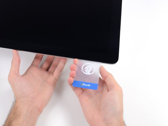

    Plastic Cards
    $2.99
    • While the opening tool cut most of the adhesive, the display will still be slightly adhered to the case. A plastic card will be necessary to free up the last of this adhesive.
    • Set the iMac face-up on a table.
    • Starting from the top right corner of the iMac, wedge a plastic card between the display and frame.
    • Be careful not to insert the plastic card more than 3/8", or you may damage internal components.

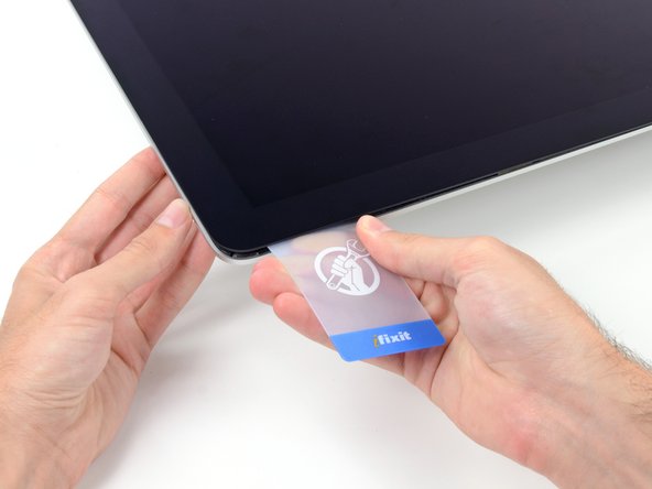

  11. iMac Intel 21.5" Retina 4K Display 2019 Power Supply Replacement: crwdns2935265:011crwdnd2935265:01crwdnd2935265:02crwdne2935265:0 iMac Intel 21.5" Retina 4K Display 2019 Power Supply Replacement: crwdns2935265:011crwdnd2935265:02crwdnd2935265:02crwdne2935265:0
    • Gently twist the plastic card sideways to create a gap between the display and frame.
    • Move slowly and be careful not to stress the display glass too much—you only need to make a gap of about 1/4".
