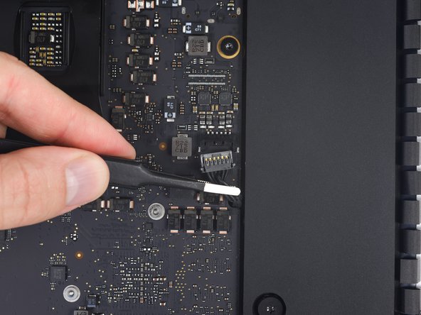

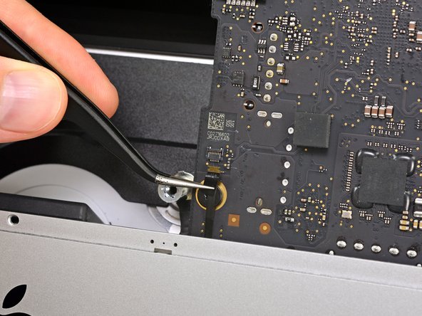

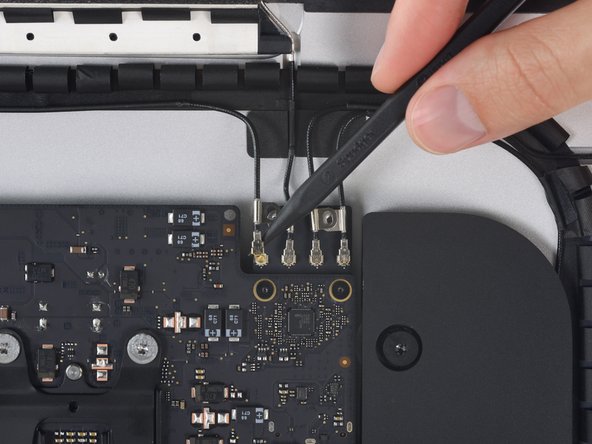

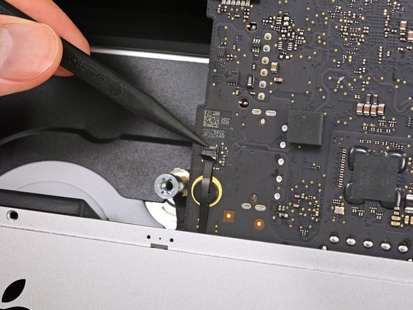

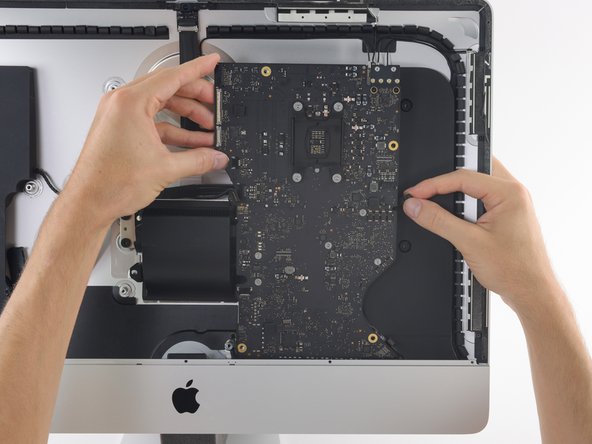

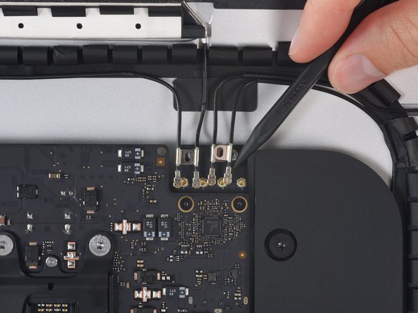

    After removing the display, I also removed the 3 screws for the processor fan, disconnected the power connector for it and set the fan shroud aside. Disconnecting the remaining cable (similar style to 1 of the cables for the display) that is in the way of the RAM chips is all that's left to do. I was then able to access and quickly remove the two Apple-provided RAM chips, and replace them with 3rd party RAM. Turning the iMac on its side, so that it's in a position where you're physically putting the RAM chips DOWNWARD into their respective slots is the best way to go about uninstalling and reinstalling the chips. Using a narrow but long'ish plastic spudger tool is the best way to defeat the spring-tabs which hold the RAM chips in place. After removing the LCD display, changing the RAM is about a 10 minute process!! And I'd SURE prefer not to remove all the parts and risk damage to the iMac via the standard procedure listed. As per usual, take your time and work gently :-)
    Mitch K - crwdns2934203:0crwdne2934203:0
    Teardown the whole machine just to change RAM? While preparing to comment on this procedure I just noticed the comment made by Mitch K above. I ran pretty much the same procedure that he describes this afternoon (steps 1-23, 43-45, and step 55). Then I swapped out the original 2x4GB RAM chips for 2x8GB chips by reaching behind the logic board, releasing the spring retaining clips one chip at a time (starting with the chip further away from the logic board), pivoting the RAM towards the back of the machine, and then carefully sliding it out of the slot. I easily slid in the new chips and then pivoted them to lock them down. No hassle, no time lost. As Mitch K states above, not only is this “shortcut” method much quicker and easier, but it provides less risk of damaging cables, sockets and other delicate components during a total teardown. Why mess with the power supply board just to change RAM? I do not advise to follow the current iFixit.com procedure written by Sam Lionheart, regardless of user skill-level.
    nycsandor - crwdns2934203:0crwdne2934203:0
    THAT sounds one !&&* of a lot easier than the full tear down. I wonder if there’s a video of the process described by Mitch K? Adding that to these verbal instructions would really help relieve the apprehension and anxiety around the process! I do sometimes find the additional warnings, though appreciated from a “safety first” perspective, are somewhat overstated. It’s been a very long time since I shorted out RAM, or fried a PCB, or broke a connector, regardless of how finicky, fragile or awkwardly designed and positioned. I may have WANTED to break something, and the air might be blue for a few seconds, but inevitably, things go back together, the start button gets pressed, the startup chime sounds, and we’re in business. Practice DOES make as close to perfect we are likely to get.
    bruce - crwdns2934203:0crwdne2934203:0
    Mitch has the exact method that works a treat. You don’t need to follow steps 24-37 and also 40-63. Step 51 is the step to remove the camera cable and is needed. Steps 38 and 39 are for the Fan. That is all that is needed. Done quite a few like this.
    Be careful not to drop the RAM down the back of the logic board!
    By NOT removing all the other stuff you can avoid either damaging it or forgetting to plug in a cable.
    Charlie Nancarrow - crwdns2934203:0crwdne2934203:0
    I just trued this shortcut and it was not successful. I was not able to seat both RAM chips with this shortcut, and managed to slightly damage one of the retainer clips. I simply could not manipulate the chips into and out of the slots effectively without taking everything apart as described in the full set of steps.. I ended up retracing my steps and following the entire procedure, carefully, and that worked without incident. So, bottomline, it is definitely more work to follow all the steps but from my experience, it is decidedly safer. Your mileage may, of course, vary. It was successful in the end, and I swapped out the hard drive with an ssd during the same procedure and my machine is very, very much faster.
    jan - crwdns2934203:0crwdne2934203:0
    I have completed by following the Mitch K post and it is much easier than stripping down the whole thing, just be aware that to remove and replace the ram chips means working in a tight space, you need slim fingers and don’t be tempted to use force, take your time.
    Barrie Price - crwdns2934203:0crwdne2934203:0
    Well, I have slim fingers, but they are 60 years old, and they don’t work like they used to! LOL.
    Jan Hogle -
    Agree with Mitch K’s procedure. The only added tip I would throw in is to use two 45 degree tweezers with their plastic covers still installed to easily pop loose the RAM. I couldn’t get the plastic spudger tool to work myself, but the tweezers easily reach the RAM clips. Just make sure the plastic covers are installed and you won’t be in danger of scratching or shorting anything out.
    charlesnick - crwdns2934203:0crwdne2934203:0
    So thankful I discovered these comments. Saved me a TON of time! Thank you!!
    Adam Roberts - crwdns2934203:0crwdne2934203:0
    These comments were very useful. Thank you. I just needed to modify a pair of tweezers to allow me to seat the new RAM more easily. The ifixit screwdriver wasn't able to turn some of the screws as they were installed too tightly, and I didn't want to wait to order and reveive a pair of right angled Torx screwdrivers that would give me more leverage to get those boards off.
    Upgrader - crwdns2934203:0crwdne2934203:0

    • Flip up the metal retaining bracket on the FaceTime camera cable connector.
    • Pull the FaceTime camera cable straight out of its socket on the logic board.
    • This is a delicate connector that can be easily damaged.

    • Remove the two 4.0 mm T5 Torx screws securing the four antenna connectors to the AirPort/Bluetooth card.
    Soyez minutieux et prudent concernant ces deux vis de la carte AirPort/Bluetooth! La tête de vis de droite pour libérer les 2 connecteurs a foirée pour moi! Elle était très serrée et j'ai du forcer... J'avais pourtant le bon tournevis... Impossible donc de la dévisser (mon tournevis n'accrochait plus la vis)... La solution était de sortir délicatement la carte AirPort/Bluetooth de la carte mère (en dévissant les deux autres vis qui la maintenait à la carte mère et aussi en décollant un peu les scotchs noirs qui maintiennent les connecteurs pour avoir un peu de marge) et ensuite en la tirant de son logement vers le haut. J'ai pu ensuite sortir délicatement la carte mère en faisant attention à la carte AirPort/Bluetooth que j'avais remonté sur le bord de l'écran! Ouf! J'aurais pu me retrouver coincée à ce niveau! (après cette frayeur, pour le reste tout s'est bien passé).
    LIN-WEE-KUAN - crwdns2934203:0crwdne2934203:0
  53. iMac Intel 21.5" Retina 4K Display (2017) RAM Replacement: crwdns2935265:053crwdnd2935265:01crwdnd2935265:03crwdne2935265:0 iMac Intel 21.5" Retina 4K Display (2017) RAM Replacement: crwdns2935265:053crwdnd2935265:02crwdnd2935265:03crwdne2935265:0 iMac Intel 21.5" Retina 4K Display (2017) RAM Replacement: crwdns2935265:053crwdnd2935265:03crwdnd2935265:03crwdne2935265:0
    • Disconnect all four antenna connectors by prying them straight up from their sockets on the AirPort/Bluetooth card.
  54. iMac Intel 21.5" Retina 4K Display (2017) RAM Replacement: crwdns2935265:054crwdnd2935265:01crwdnd2935265:03crwdne2935265:0 iMac Intel 21.5" Retina 4K Display (2017) RAM Replacement: crwdns2935265:054crwdnd2935265:02crwdnd2935265:03crwdne2935265:0 iMac Intel 21.5" Retina 4K Display (2017) RAM Replacement: crwdns2935265:054crwdnd2935265:03crwdnd2935265:03crwdne2935265:0
    • Use the flat edge of a spudger to pry the headphone jack cable connector from its socket on the logic board.
    • This connector is located on the bottom right edge of the logic board, near the right speaker.
    • Push the cable up and out of the way of the logic board.

  60. iMac Intel 21.5" Retina 4K Display (2017) RAM Replacement: crwdns2935265:060crwdnd2935265:01crwdnd2935265:01crwdne2935265:0
    • When removing and installing the logic board, take care not to damage the delicate microphone ribbon cable at the bottom left.
    • Lift the logic board straight up and out of the iMac.
    • Be careful not to snag the board on any of the rear enclosure's screw posts.
    At step 60, when reinstalling the logic board, check to make sure the I/O ports are flush with the back of the case. It’s easy to end up with a small gap, and if you do, you won’t be able to fully insert USB-C connectors.
    roberttrevellyan - crwdns2934203:0crwdne2934203:0
    I’d like to second this. Screw in the four logic board screws very loosley. Then make sure all the cables are where they should be. Then push the bottom of the board back until you feel it snap into place. Then tighten the four screws. At this point, before going any further, test out all the ports with some plugs to make sure everything goes in nice and easy.
    John M - crwdns2934203:0crwdne2934203:0
    Especially the USB-C's, these are the most delicate ones...
    Froggy Manny - crwdns2934203:0crwdne2934203:0
