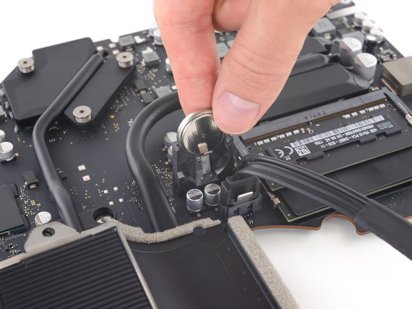

iMac Intel 21.5" Retina 4K Display (2017) PRAM Battery Replacement

    • Use a spudger to disconnect the single SATA power and data combo cable by gently prying its large plastic connector away from the hard drive.

  61. iMac Intel 21.5" Retina 4K Display (2017) PRAM Battery Replacement, PRAM Battery: crwdns2935265:061crwdnd2935265:01crwdnd2935265:02crwdne2935265:0 iMac Intel 21.5" Retina 4K Display (2017) PRAM Battery Replacement, PRAM Battery: crwdns2935265:061crwdnd2935265:02crwdnd2935265:02crwdne2935265:0
    • Pull the PRAM battery straight up and out of its socket.
