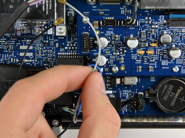

    • Move the antenna cables away from the audio board.

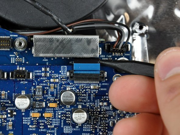

    • Using the tip of a spudger, flip up the audio to logic board ribbon cable retaining flap (toward the bottom of your iMac).
    • Pull the audio to logic board ribbon cable straight out of its socket.
