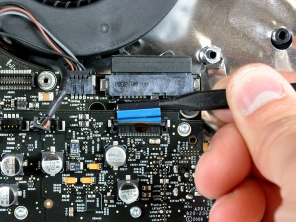

  16. iMac Intel 20" EMC 2266 Audio Board Replacement: crwdns2935265:016crwdnd2935265:01crwdnd2935265:02crwdne2935265:0 iMac Intel 20" EMC 2266 Audio Board Replacement: crwdns2935265:016crwdnd2935265:02crwdnd2935265:02crwdne2935265:0
    • Using the tip of a spudger, flip up the audio to logic board ribbon cable retaining flap (toward the bottom edge of your iMac).
    • Pull the audio to logic board ribbon cable straight out of its socket.
