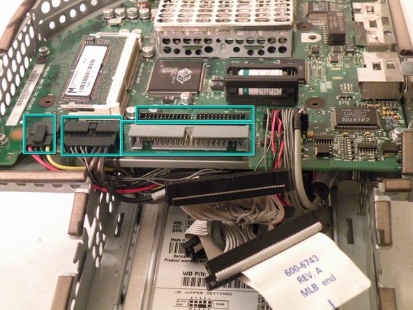

  14. iMac G3 Model M4984 Hard Drive Replacement: crwdns2935265:014crwdnd2935265:01crwdnd2935265:02crwdne2935265:0 iMac G3 Model M4984 Hard Drive Replacement: crwdns2935265:014crwdnd2935265:02crwdnd2935265:02crwdne2935265:0
    • Start by removing these Phillips screws:
    • Now, remove all of these cables:
  15. iMac G3 Model M4984 Hard Drive Replacement: crwdns2935265:015crwdnd2935265:01crwdnd2935265:02crwdne2935265:0 iMac G3 Model M4984 Hard Drive Replacement: crwdns2935265:015crwdnd2935265:02crwdnd2935265:02crwdne2935265:0
