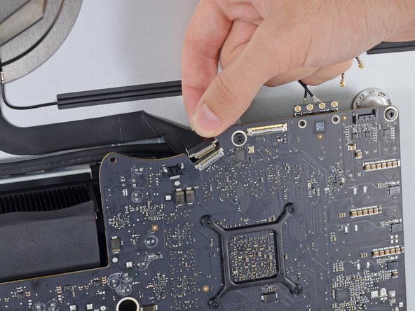

    19. iMac 27" 2017 Blade SSD Replacement, Disconnect the display cables: crwdns2935265:019crwdnd2935265:01crwdnd2935265:02crwdne2935265:0 iMac 27" 2017 Blade SSD Replacement, Disconnect the display cables: crwdns2935265:019crwdnd2935265:02crwdnd2935265:02crwdne2935265:0
      • While holding the display up with one hand, use the other to unplug the display power cable.
      • Lift the display up enough to have easy access to the connections, but not so much that you stretch the cables and stress their connections (about 8").
    20. iMac 27" 2017 Blade SSD Replacement: crwdns2935265:020crwdnd2935265:01crwdnd2935265:03crwdne2935265:0 iMac 27" 2017 Blade SSD Replacement: crwdns2935265:020crwdnd2935265:02crwdnd2935265:03crwdne2935265:0 iMac 27" 2017 Blade SSD Replacement: crwdns2935265:020crwdnd2935265:03crwdnd2935265:03crwdne2935265:0
      • Flip up the metal retaining bracket on the display data cable.
      • Disconnect the display data cable.
      • This is a delicate connection that can easily be broken. Be sure to pull the display data cable connector straight out of its socket, toward the top of the iMac.

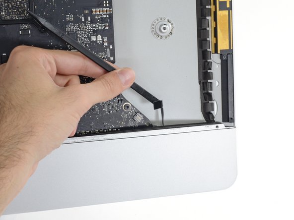

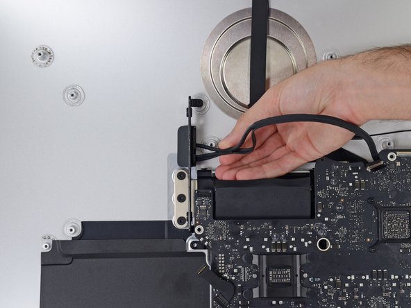

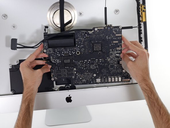

    1. iMac 27" 2017 Blade SSD Replacement, Remove the left speaker: crwdns2935265:026crwdnd2935265:01crwdnd2935265:01crwdne2935265:0
      • Remove two 10 mm T10 screws.

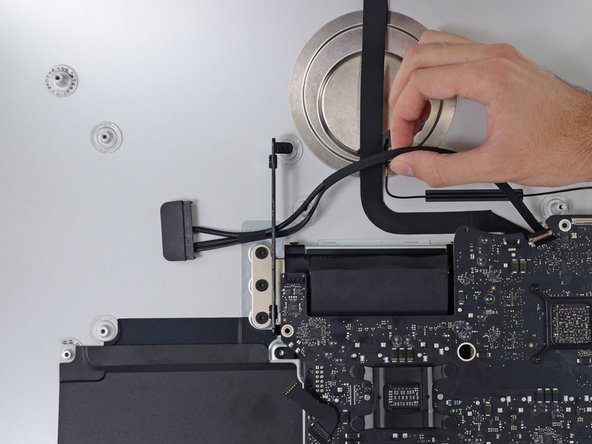

    2. iMac 27" 2017 Blade SSD Replacement: crwdns2935265:027crwdnd2935265:01crwdnd2935265:03crwdne2935265:0 iMac 27" 2017 Blade SSD Replacement: crwdns2935265:027crwdnd2935265:02crwdnd2935265:03crwdne2935265:0 iMac 27" 2017 Blade SSD Replacement: crwdns2935265:027crwdnd2935265:03crwdnd2935265:03crwdne2935265:0
      • Unplug the left speaker cable by pulling it straight up out of its socket on the logic board.
      • De-route the cable from the gap between the hard drive and logic board.
      • If the gap between the hard drive and logic board is too narrow for the speaker cable, disconnect it and leave the cable in place.

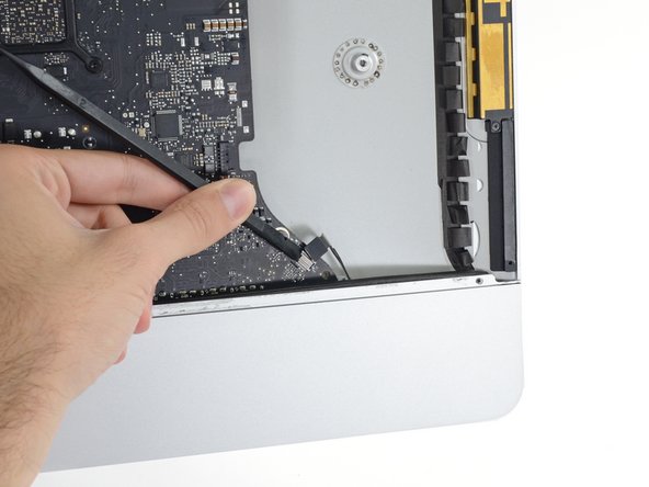

    3. iMac 27" 2017 Blade SSD Replacement: crwdns2935265:028crwdnd2935265:01crwdnd2935265:03crwdne2935265:0 iMac 27" 2017 Blade SSD Replacement: crwdns2935265:028crwdnd2935265:02crwdnd2935265:03crwdne2935265:0 iMac 27" 2017 Blade SSD Replacement: crwdns2935265:028crwdnd2935265:03crwdnd2935265:03crwdne2935265:0
      • Be careful not to touch any solder joints on the back of the power supply. Capacitors may be charged enough to give you a dangerous shock.
      • Use a spudger to disconnect the power button connector from its socket on the logic board.
    4. iMac 27" 2017 Blade SSD Replacement: crwdns2935265:029crwdnd2935265:01crwdnd2935265:02crwdne2935265:0 iMac 27" 2017 Blade SSD Replacement: crwdns2935265:029crwdnd2935265:02crwdnd2935265:02crwdne2935265:0

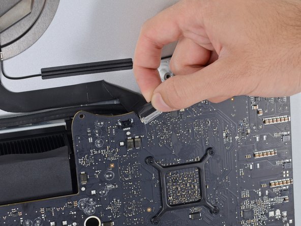

      • Lift the left speaker straight up, until the power button cable is exposed (about 0.5 inches).
    5. iMac 27" 2017 Blade SSD Replacement: crwdns2935265:030crwdnd2935265:01crwdnd2935265:03crwdne2935265:0 iMac 27" 2017 Blade SSD Replacement: crwdns2935265:030crwdnd2935265:02crwdnd2935265:03crwdne2935265:0 iMac 27" 2017 Blade SSD Replacement: crwdns2935265:030crwdnd2935265:03crwdnd2935265:03crwdne2935265:0
      • Gently de-route the power button cable from its groove in the left speaker.
    6. iMac 27" 2017 Blade SSD Replacement: crwdns2935265:031crwdnd2935265:01crwdnd2935265:03crwdne2935265:0 iMac 27" 2017 Blade SSD Replacement: crwdns2935265:031crwdnd2935265:02crwdnd2935265:03crwdne2935265:0 iMac 27" 2017 Blade SSD Replacement: crwdns2935265:031crwdnd2935265:03crwdnd2935265:03crwdne2935265:0

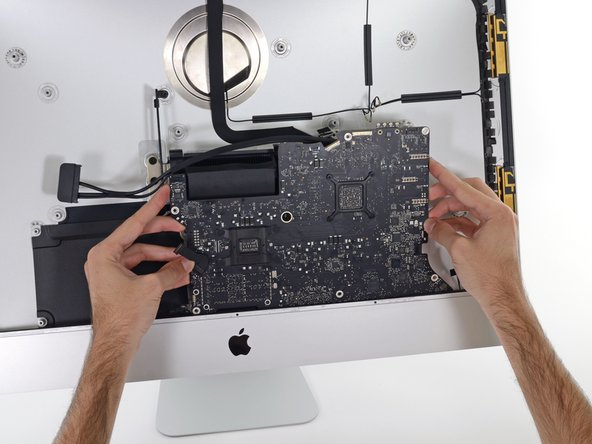

      • Lift the left speaker straight up and remove it from the iMac.
      • If the gap between the hard drive and logic board was too narrow to free the speaker cable earlier, gently pull it free as you remove the speaker.
      • Push from the connector end as you pull from the speaker end to thread the cable under the hard drive's right bracket.

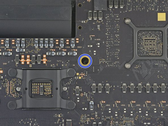

    1. iMac 27" 2017 Blade SSD Replacement, Remove the power supply: crwdns2935265:036crwdnd2935265:01crwdnd2935265:02crwdne2935265:0 iMac 27" 2017 Blade SSD Replacement, Remove the power supply: crwdns2935265:036crwdnd2935265:02crwdnd2935265:02crwdne2935265:0
      • When working on the power supply, be very careful not to touch the capacitor leads or any exposed solder joints on the back of the power supply. Only handle the board by the edges.
      • Disconnect the power supply control cable from the power supply.
    2. iMac 27" 2017 Blade SSD Replacement: crwdns2935265:037crwdnd2935265:01crwdnd2935265:01crwdne2935265:0
      • Remove the following four screws securing the power supply to the rear case (size T8 or T10 depending on the exact model):
      • Two 23.7 mm Torx screws
      • Two 7.3 mm Torx screws
    3. iMac 27" 2017 Blade SSD Replacement: crwdns2935265:038crwdnd2935265:01crwdnd2935265:03crwdne2935265:0 iMac 27" 2017 Blade SSD Replacement: crwdns2935265:038crwdnd2935265:02crwdnd2935265:03crwdne2935265:0 iMac 27" 2017 Blade SSD Replacement: crwdns2935265:038crwdnd2935265:03crwdnd2935265:03crwdne2935265:0
      • Do not attempt to remove the power supply from the case; it is still attached to the logic board by two cables.
      • Move the power supply board towards the left edge of the case and up to free it from the notch in the logic board.
    4. iMac 27" 2017 Blade SSD Replacement: crwdns2935265:039crwdnd2935265:01crwdnd2935265:02crwdne2935265:0 iMac 27" 2017 Blade SSD Replacement: crwdns2935265:039crwdnd2935265:02crwdnd2935265:02crwdne2935265:0
      • Depress the tab on the DC power cable connector, then pull it straight out of its socket on the back of the logic board.
      • If the cable is too difficult to disconnect, you can remove the power supply board and motherboard together.

      • Flip the top of the power supply towards you, like opening a mailbox, to reveal the AC inlet cable connector.
      • Disconnect the AC inlet cable connector.

      • Use a spudger to loosen the right speaker cable's connector from its socket on the logic board.
      • Pull the connector to the right to remove it from its socket.

    3. iMac 27" 2017 Blade SSD Replacement: crwdns2935265:051crwdnd2935265:01crwdnd2935265:03crwdne2935265:0 iMac 27" 2017 Blade SSD Replacement: crwdns2935265:051crwdnd2935265:02crwdnd2935265:03crwdne2935265:0 iMac 27" 2017 Blade SSD Replacement: crwdns2935265:051crwdnd2935265:03crwdnd2935265:03crwdne2935265:0
      • This is a delicate connection that can be easily broken.
      • Flip up the metal retaining bracket on the iSight camera cable.
      • Pull the camera cable connector straight out of its socket, toward the top of the iMac.
    4. iMac 27" 2017 Blade SSD Replacement: crwdns2935265:052crwdnd2935265:01crwdnd2935265:03crwdne2935265:0 iMac 27" 2017 Blade SSD Replacement: crwdns2935265:052crwdnd2935265:02crwdnd2935265:03crwdne2935265:0 iMac 27" 2017 Blade SSD Replacement: crwdns2935265:052crwdnd2935265:03crwdnd2935265:03crwdne2935265:0
      • Use the flat end of a spudger to disconnect the headphone jack cable connector from its socket on the logic board.
      • Gently push the cable out of the way.
    5. iMac 27" 2017 Blade SSD Replacement: crwdns2935265:053crwdnd2935265:01crwdnd2935265:03crwdne2935265:0 iMac 27" 2017 Blade SSD Replacement: crwdns2935265:053crwdnd2935265:02crwdnd2935265:03crwdne2935265:0 iMac 27" 2017 Blade SSD Replacement: crwdns2935265:053crwdnd2935265:03crwdnd2935265:03crwdne2935265:0
      • Use the tip of a spudger to flip open the retaining flap on the microphone ribbon cable ZIF socket.
      • Use tweezers to gently pull the microphone ribbon cable straight out of its socket.

      • One captive T8 screw
      • This screw is beneath a hole in the logic board. If you aren't using an iFixit driver, you may need an extension or a screwdriver with a longer shaft.

    9. iMac 27" 2017 Blade SSD Replacement: crwdns2935265:057crwdnd2935265:01crwdnd2935265:03crwdne2935265:0 iMac 27" 2017 Blade SSD Replacement: crwdns2935265:057crwdnd2935265:02crwdnd2935265:03crwdne2935265:0 iMac 27" 2017 Blade SSD Replacement: crwdns2935265:057crwdnd2935265:03crwdnd2935265:03crwdne2935265:0
      • When removing and installing the logic board, take care not to damage the delicate microphone ribbon cable at the bottom left of the board.
      • Tilt the logic board slightly forward.
      • Lift the logic board straight up and out of the iMac. Be careful not to snag it on any of the screw posts attached to the inside of the rear case.
    10. iMac 27" 2017 Blade SSD Replacement: crwdns2935265:058crwdnd2935265:01crwdnd2935265:02crwdne2935265:0 iMac 27" 2017 Blade SSD Replacement: crwdns2935265:058crwdnd2935265:02crwdnd2935265:02crwdne2935265:0
      • When reassembling your iMac, be very careful to align the exterior I/O ports correctly. The logic board can sit crooked even when secured with all its screws.
      • You can use a USB flashdrive or ethernet cable to ensure the logic board is seated correctly while you screw it in.
