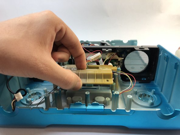

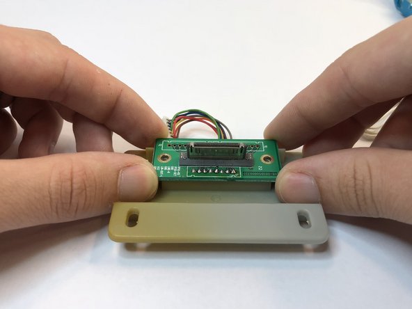

  11. iHome iH3L Dock Replacement, Dock: crwdns2935265:011crwdnd2935265:01crwdnd2935265:03crwdne2935265:0 iHome iH3L Dock Replacement, Dock: crwdns2935265:011crwdnd2935265:02crwdnd2935265:03crwdne2935265:0 iHome iH3L Dock Replacement, Dock: crwdns2935265:011crwdnd2935265:03crwdnd2935265:03crwdne2935265:0
    • Remove the four screws from the mounting bracket.
    • Two 11.7 mm Phillips #2 screws.
    • Two 12 mm Phillips #2 screws with metal washers attached to them.

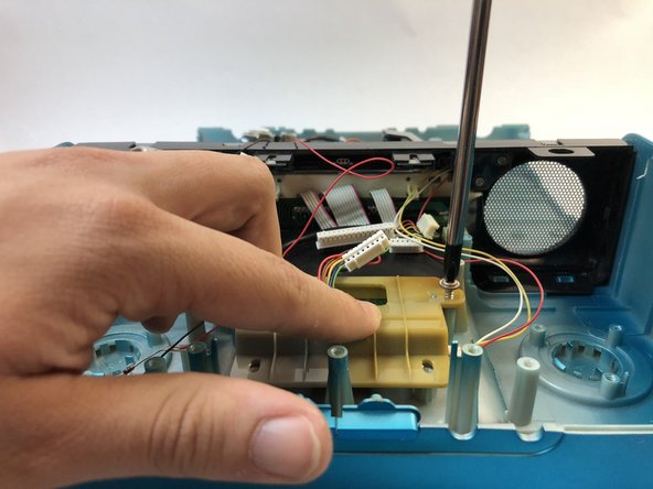

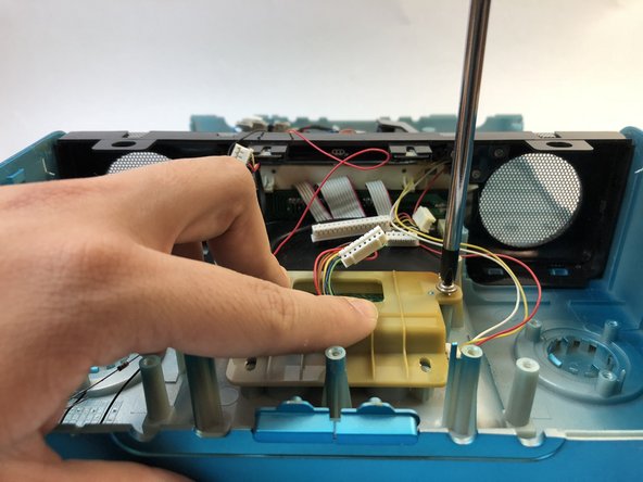

  12. iHome iH3L Dock Replacement: crwdns2935265:012crwdnd2935265:01crwdnd2935265:02crwdne2935265:0 iHome iH3L Dock Replacement: crwdns2935265:012crwdnd2935265:02crwdnd2935265:02crwdne2935265:0
    • Lift out the bracket and rotate it towards you.
  13. iHome iH3L Dock Replacement: crwdns2935265:013crwdnd2935265:01crwdnd2935265:03crwdne2935265:0 iHome iH3L Dock Replacement: crwdns2935265:013crwdnd2935265:02crwdnd2935265:03crwdne2935265:0 iHome iH3L Dock Replacement: crwdns2935265:013crwdnd2935265:03crwdnd2935265:03crwdne2935265:0

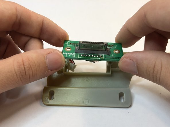

    • Unscrew the two 10 mm Phillips #2 screws and remove the dock and chip.
    • The wiring harness is loaded through the bracket, so be careful when removing the chip.
