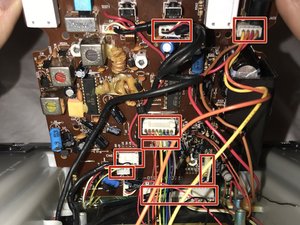

Carefully tilt the motherboard up from the front.
Disconnect the 8 connections by gently pulling on them. Starting from the front and work your way backwards.
All 8 connectors disconnected.
