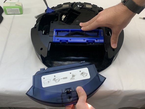

    • Make sure your device is turned off.
    • Flip the device upside down on a flat surface.
  2. eufy Clean RoboVac G32 Pro Power Control Buttons Replacement: crwdns2935265:02crwdnd2935265:01crwdnd2935265:01crwdne2935265:0
    • Press the clips at the bottom of the device that are indicated by the downward facing arrows.
    • Take off the rolling brush cover.
  3. eufy Clean RoboVac G32 Pro Power Control Buttons Replacement: crwdns2935265:03crwdnd2935265:01crwdnd2935265:01crwdne2935265:0
    • Pull the rolling brush up on the right side. Remove the rolling brush.

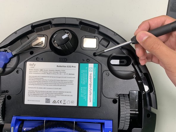

    • Remove the two 5.5 mm screws using a Philips #1 screwdriver.
  10. eufy Clean RoboVac G32 Pro Power Control Buttons Replacement: crwdns2935265:010crwdnd2935265:01crwdnd2935265:02crwdne2935265:0 eufy Clean RoboVac G32 Pro Power Control Buttons Replacement: crwdns2935265:010crwdnd2935265:02crwdnd2935265:02crwdne2935265:0
    • Remove the eight 14 mm screws using a Philips #1 screwdriver.

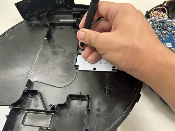

    • Remove the six 5.5 mm screws securing the button board with a Phillips #1 screwdriver.
  13. eufy Clean RoboVac G32 Pro Power Control Buttons Replacement: crwdns2935265:013crwdnd2935265:01crwdnd2935265:01crwdne2935265:0
    • Grab the 8 pin connector with your hands and firmly pull it away from the board.
    • Remove the board.
