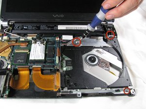

Remove the 3 indicated screws.
There are two small scews arounds the edge and one is on top of the optical drive.
